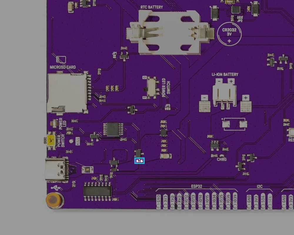

The Inkplate 10 can be configured to power on automatically when current is present, bypassing the power switch.
To bypass the power switch, simply short the R34 pads by directlly adding a small amount of solder, or soldering a 0ohm resistor. The location of these pads is shown below:
R34 connection highlighted
