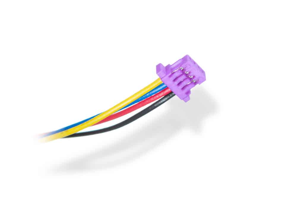

The 4-pin Qwiic cable follows this standard color coding:
ColorFunction
BlackGND (Ground)
Red5V / 3V3 (Power)
BlueSDA (I2C Data)
YellowSCL (I2C Clock)
Qwiic (formerly easyC) cable closeup
Qwiic connector closeup

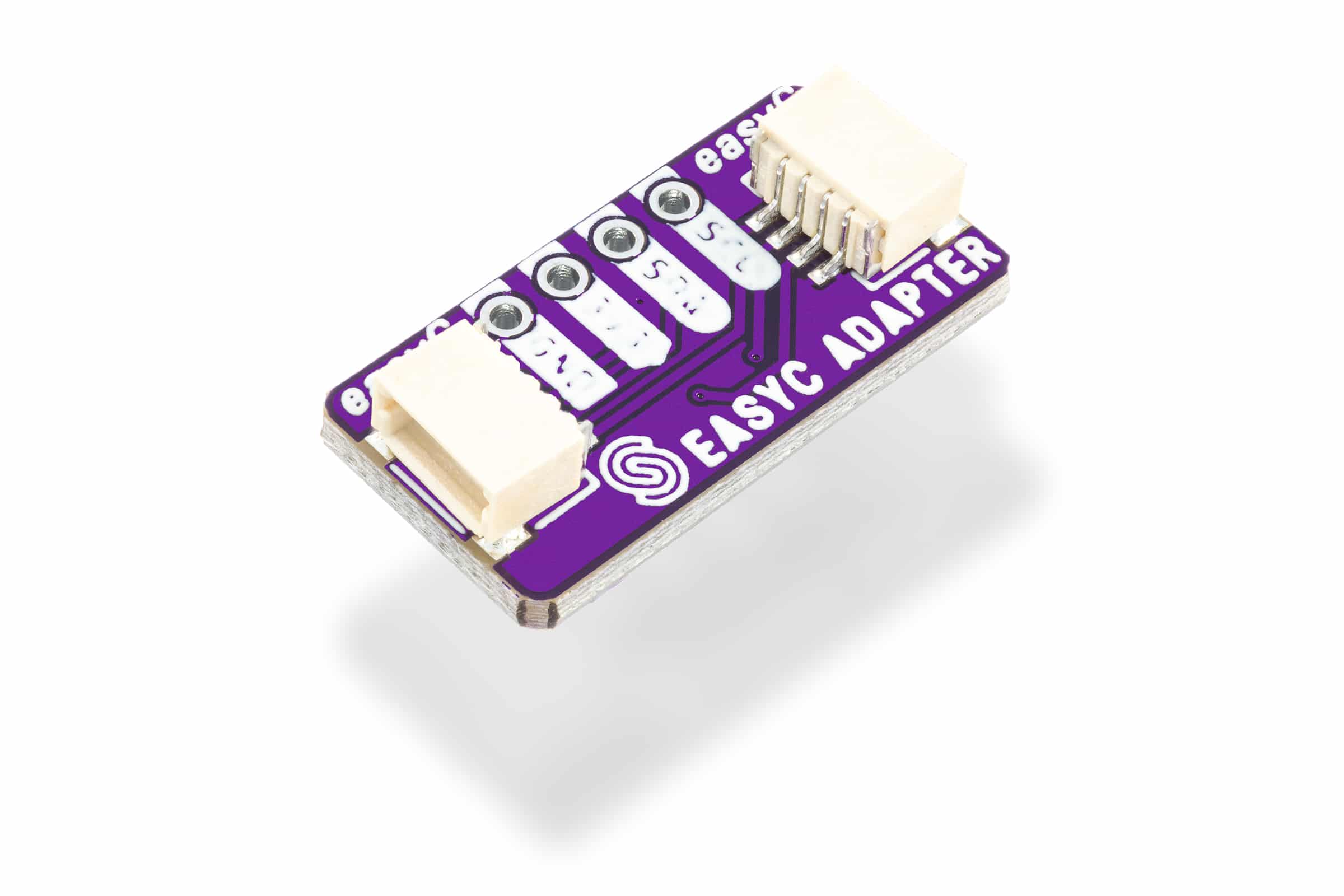

Qwiic adapter
Qwiic adapter
Qwiic (formerly easyC) adapter to turn a header pin connection into two female Qwiic ports.
