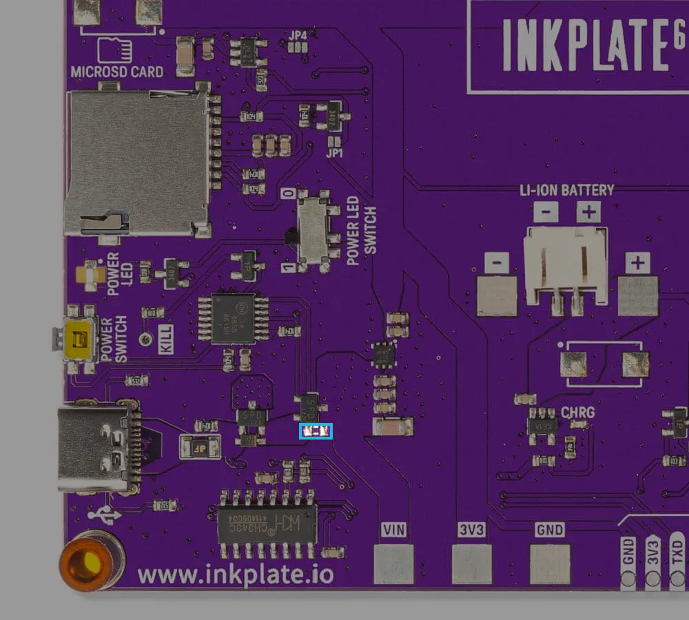

The Inkplate 6 can be configured to power on automatically when current is present, bypassing the power switch.
To bypass the power switch, simply short the R18 pads by directlly adding a small amount of solder, or soldering a 0ohm resistor. The location of these pads is shown below:
Power switch location on Inkplate 6
R18 connection highlighted
