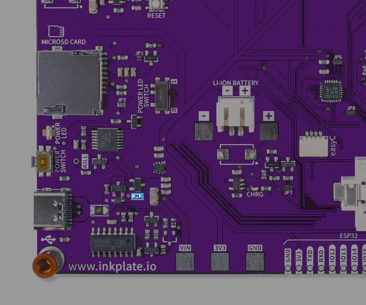

The Inkplate 6FLICK can be configured to power on automatically when current is present, bypassing the power switch.
To bypass the power switch, simply short the R36 pads by directlly adding a small amount of solder, or soldering a 0ohm resistor. The location of these pads is shown below:
R36 connection highlighted
