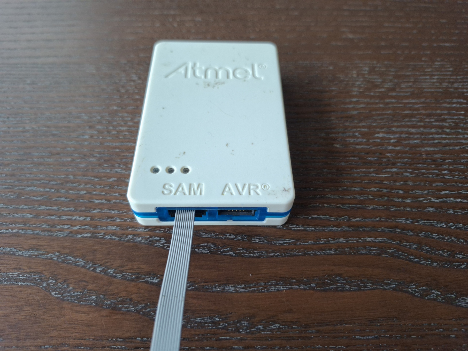

Connect one side of the 10-pin IDC flat cable to the programmer in the port marked AVR as shown in the picture below:
Flat cable connected to MakerICE
Flat cable connected to Atmel-ICE

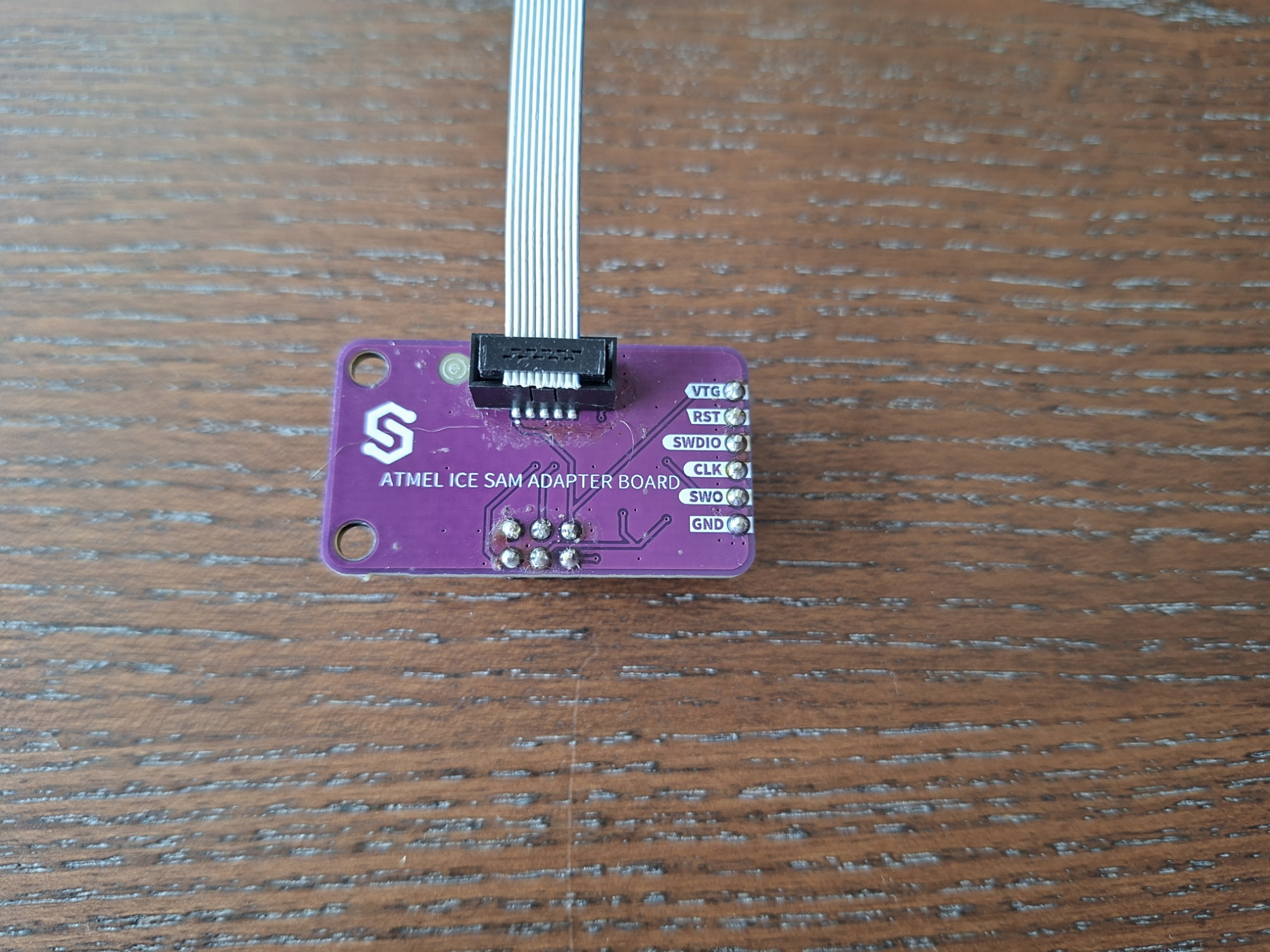

After that, connect the other side to the adapter breakout as shown in the picture below:
MakerICE SAM adapter
MakerICE SAMs adapter

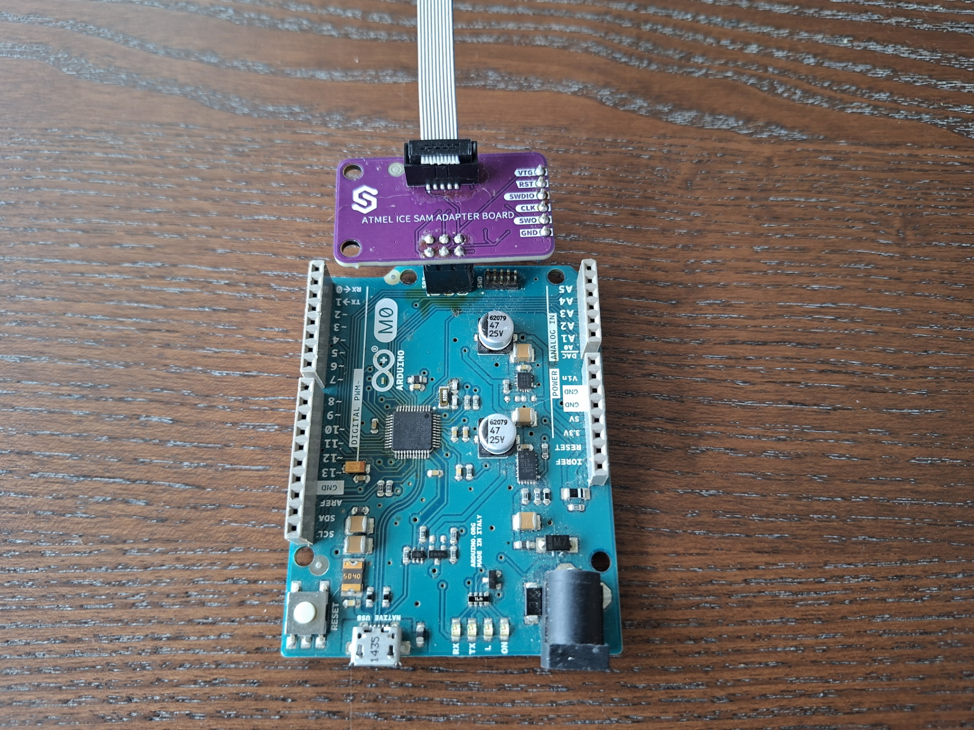

Connect the adapter a supported board:
MakerICE Adapter SAM connected to SAM supported board
