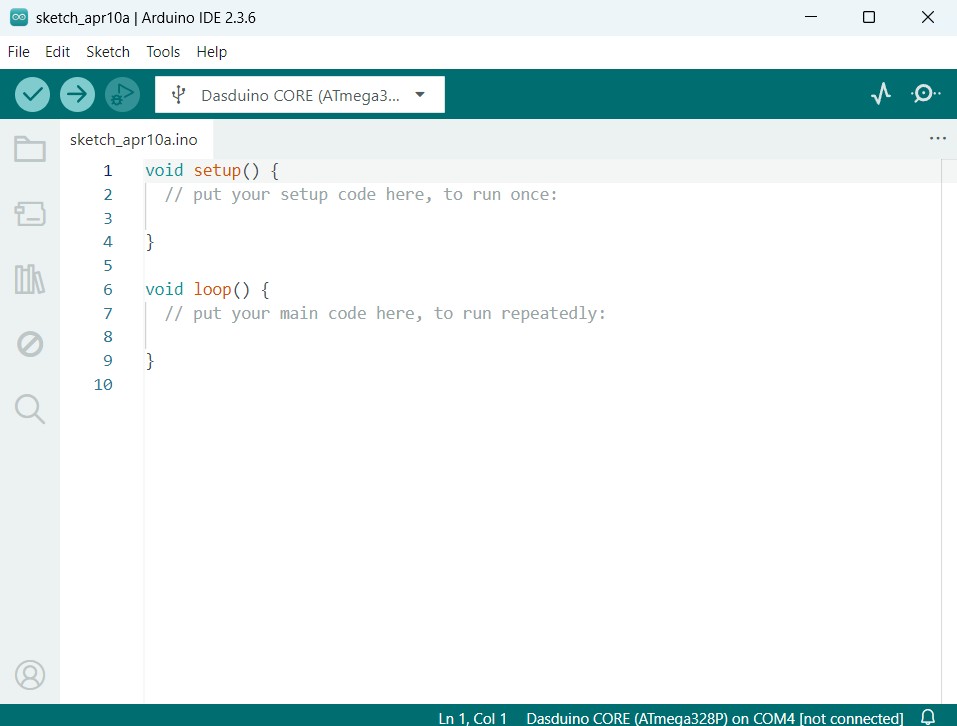

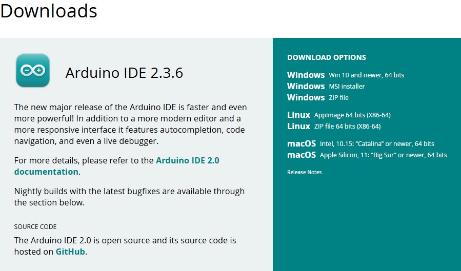

1. Install Arduino IDE
If you haven't installed it yet, download and install the Arduino IDE from the official website.
The latest version of Arduino is recommended.
Download options for the latest release
Arduino IDE 2.0
Arduino IDE 2.0

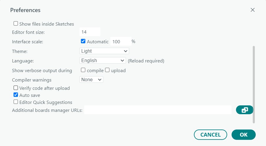

And add it to the Additional boards manager URLs in Arduino settings:
Arduino IDE 2.0
Arduino IDE 2.0
Preferences menu in settings
Adding the Dasduino boards link to Arduino IDE

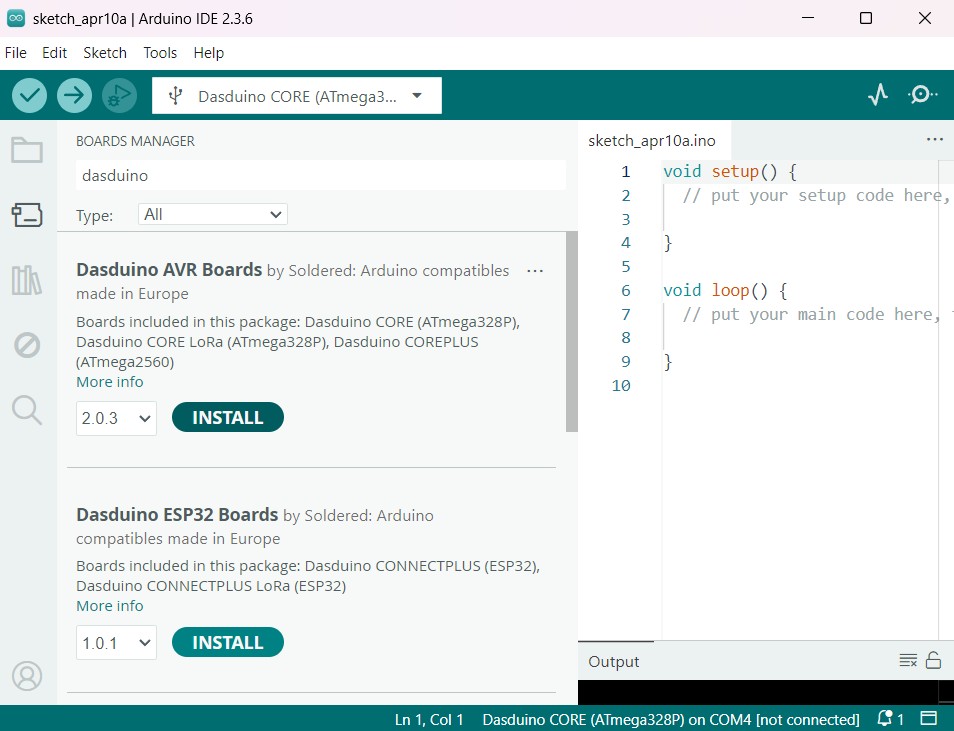

Now, you can open the Boards Manager, search for Dasduino, and install the board definition for your specific board. Check the definition's description to ensure your board is included in that specific definition!
Adding Dasduino boards to Arduino IDE

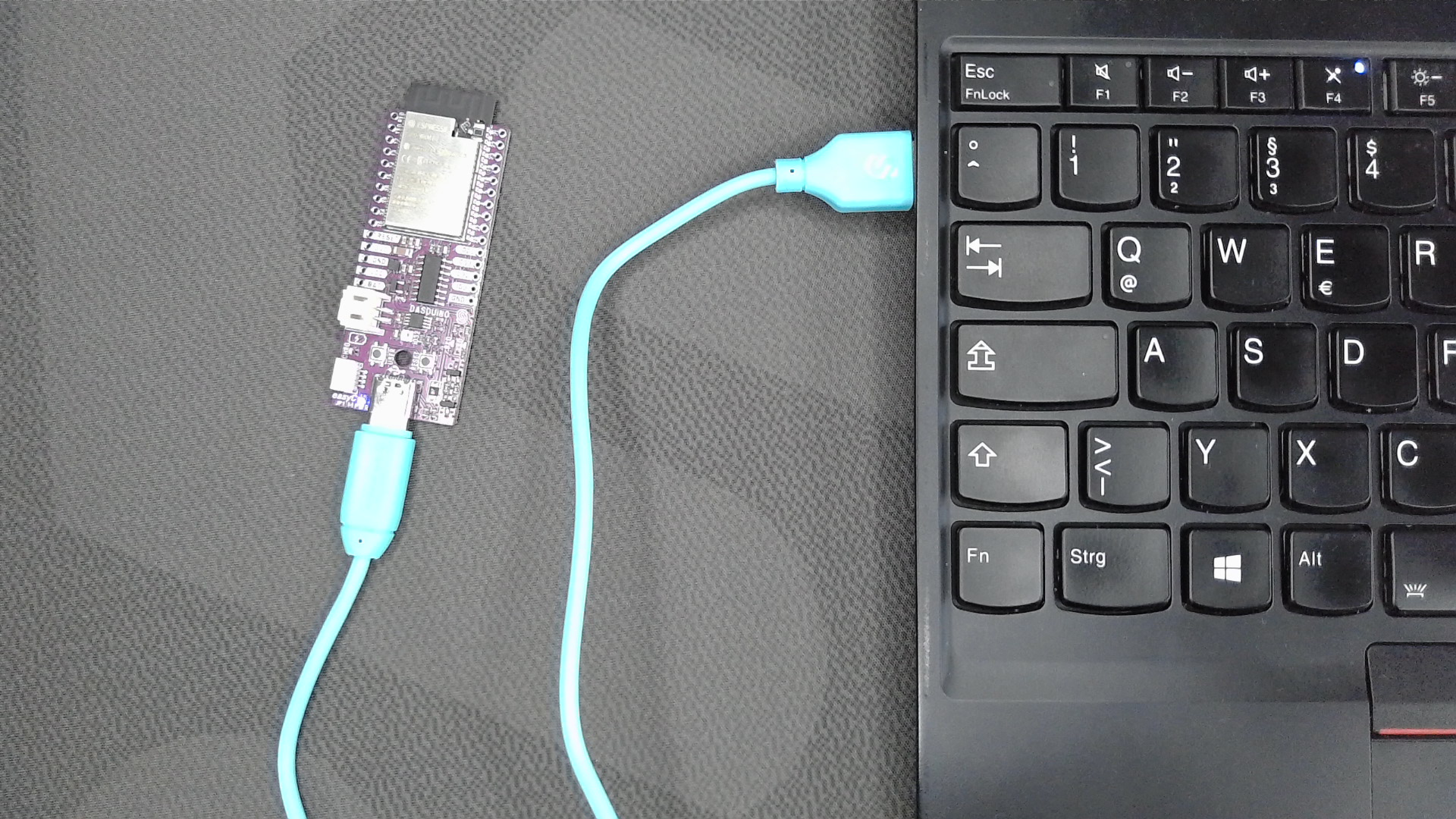

3. Connect the Dasduino board via USB
Use the provided USB-C cable to connect the Dasduino board to your computer.
Connection via USB
Connection via USB

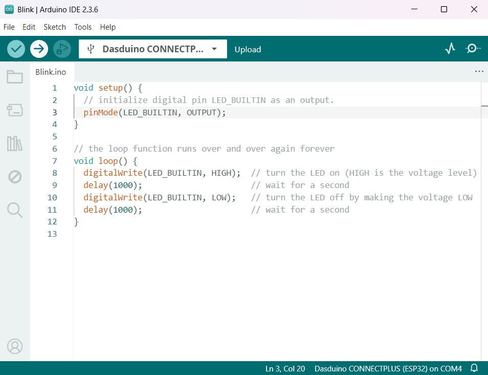

5. Upload your first code
In this example, we will use a modified version of the premade example called Blink to test if everything is running correctly. Simply copy the code below into the Arduino IDE.
void setup() {
// Initialize pin 14 as OUTPUT
pinMode(14, OUTPUT);
// the loop function runs over and over again forever
void loop() {
digitalWrite(14, HIGH); // turn the LED on
delay(1000); // wait for a second
digitalWrite(14, LOW); // turn the LED off

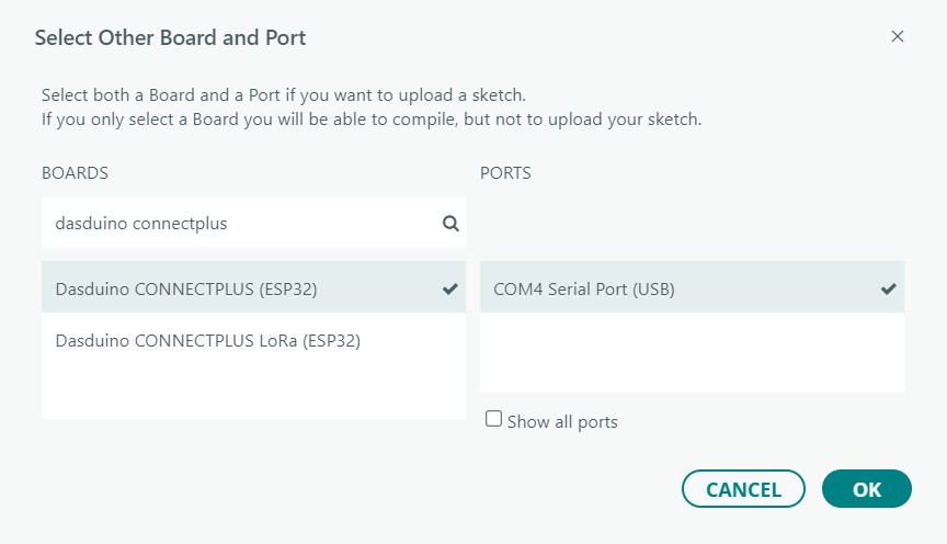

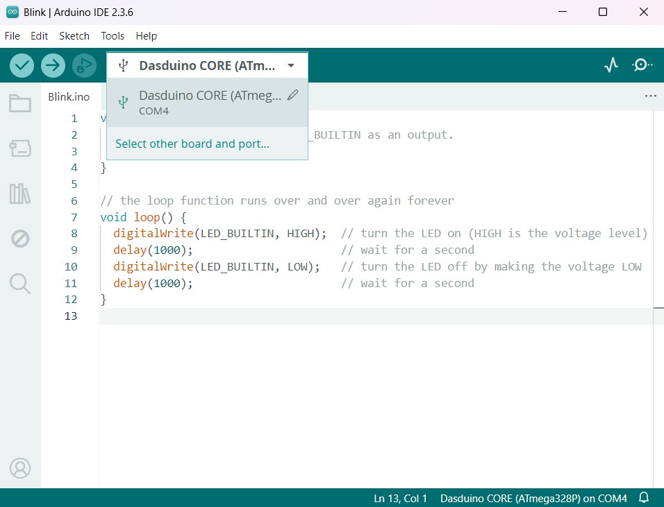

Click on the Board and port select dropdown menu and select the Select other board and port button.
Board select dropdown menu
Search for your specific board. In this example, we use DasduinoCONNECTPLUS. Select the port to which the board is connected. If more ports are available, in most cases the correct port is the one with the largest number in its name.
Board and Port selection
Upload the code to the board by pressing the Upload button in the top left corner.
Upload code button
Upload code button
If the code doesn't upload, try selecting a different port.
If all of the steps were completed correctly, your LED should blink.
