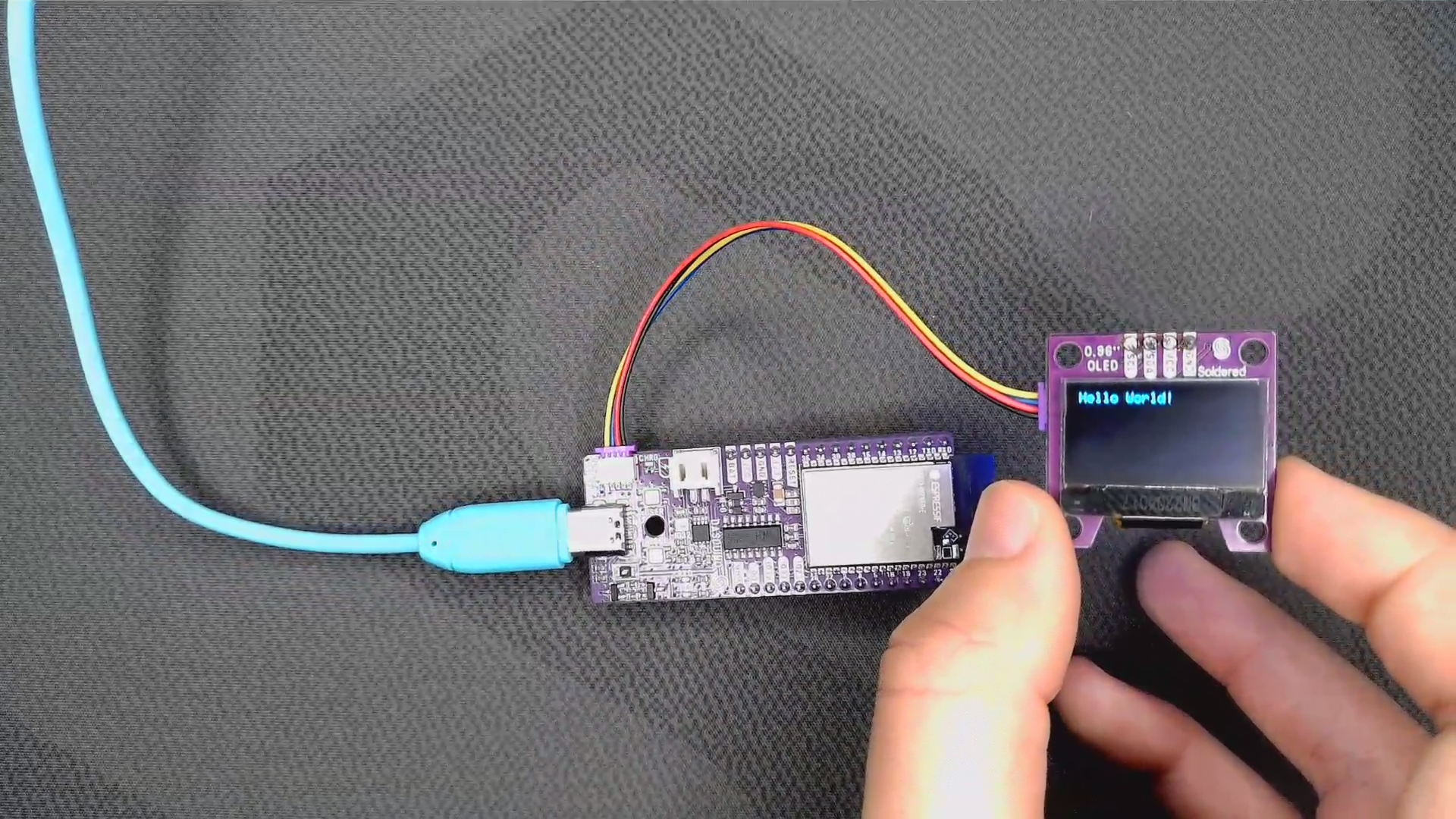

Ssd1306 – Writing text
To write text onto the display, you must define the text size, color, and the starting coordinate from which the text will be drawn onto the display.
void loop() {
delay(1000);
// Clear the last image shown on screen
display.clearDisplay();
// Normal 1:1 pixel scale
display.setTextSize(1);
// Draw white text
display.setTextColor(SSD1306_WHITE);
// Start at top-left corner
display.setCursor(0, 0);
// Message we want to display
String message = "Hello World!";
// Inform the display of the text you want to print
display.print(message);
// Display the message
display.display();
