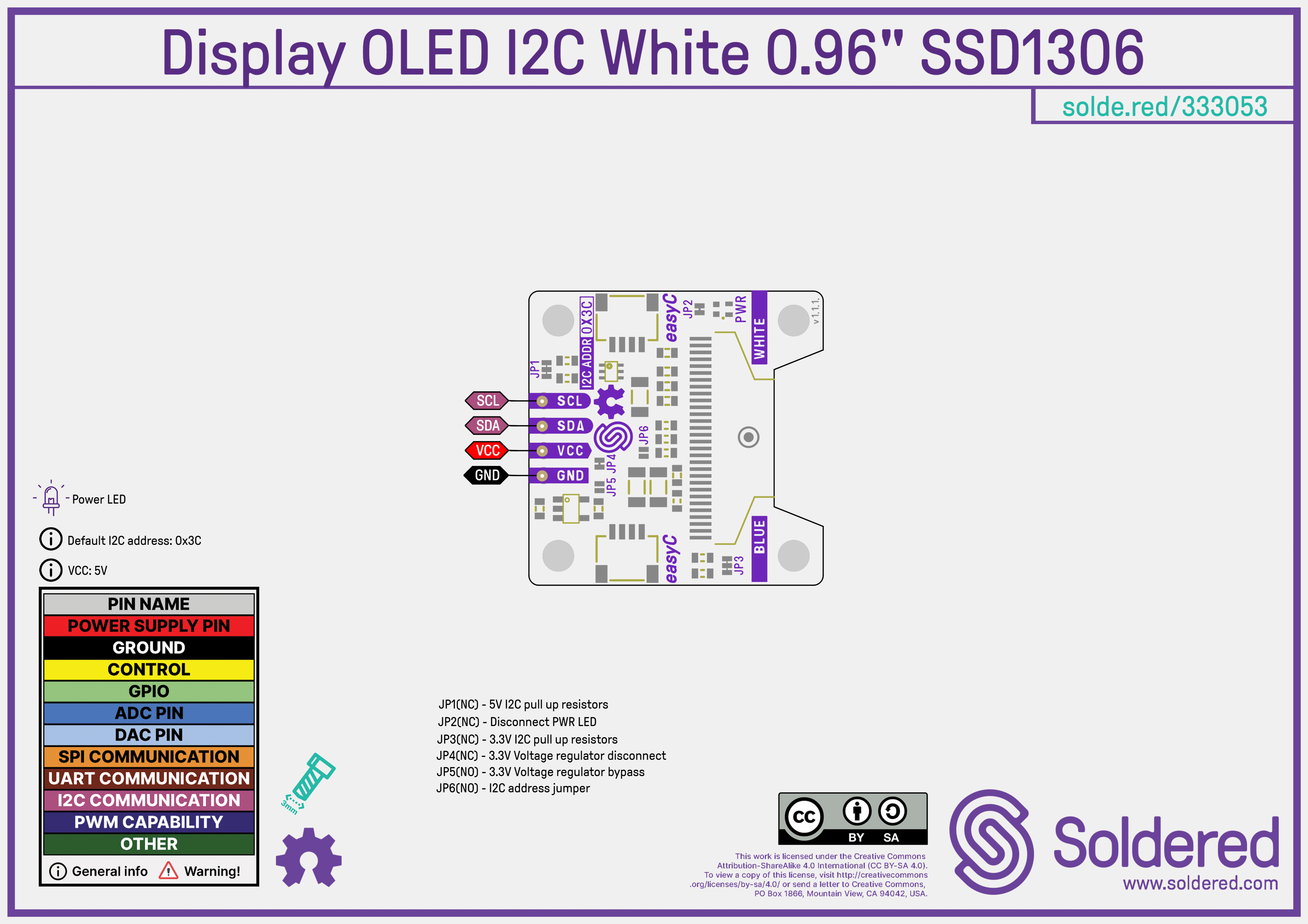

Pinout
This breakout board operates at 5V logic level but includes an onboard regulator for 3.3V compatibility, so it can be connected to both 3.3V and 5V logic boards!

Jumper details​
Loading carousel...
JumperDefault StateFunction
JP2NC (Normally closed)Supplies power to the purple LED that indicates the display is turned on.
JP3NC (Normally closed)Connects SDA/SCL pull-up resistors to 3.3V for I2C communication.
JP4NC (Normally closed)Connects the VCC pin to a 5V to 3V3 voltage regulator IC.
JP5NO (Normally open)When connected, bypasses the voltage regulator on VCC pin, allowing 3V3 to be connected instead of 5V on VCC pin. Make sure JP4 is disconnected if JP5 is connected.
JP6NO (Normally open)I2C address jumper. When shorted, the address is 0x3D; if not, it is 0x3C.
