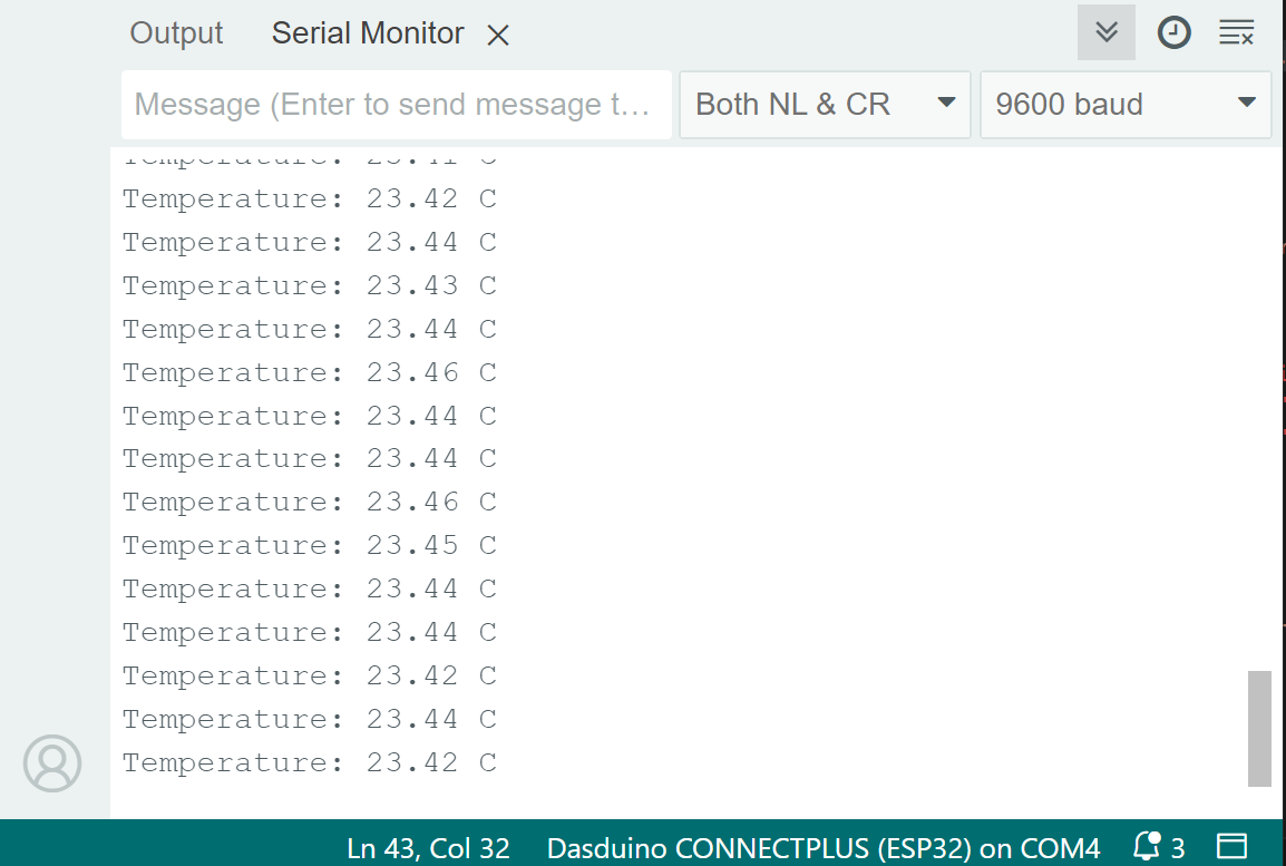

Serial monitor temperature readings
Serial monitor
