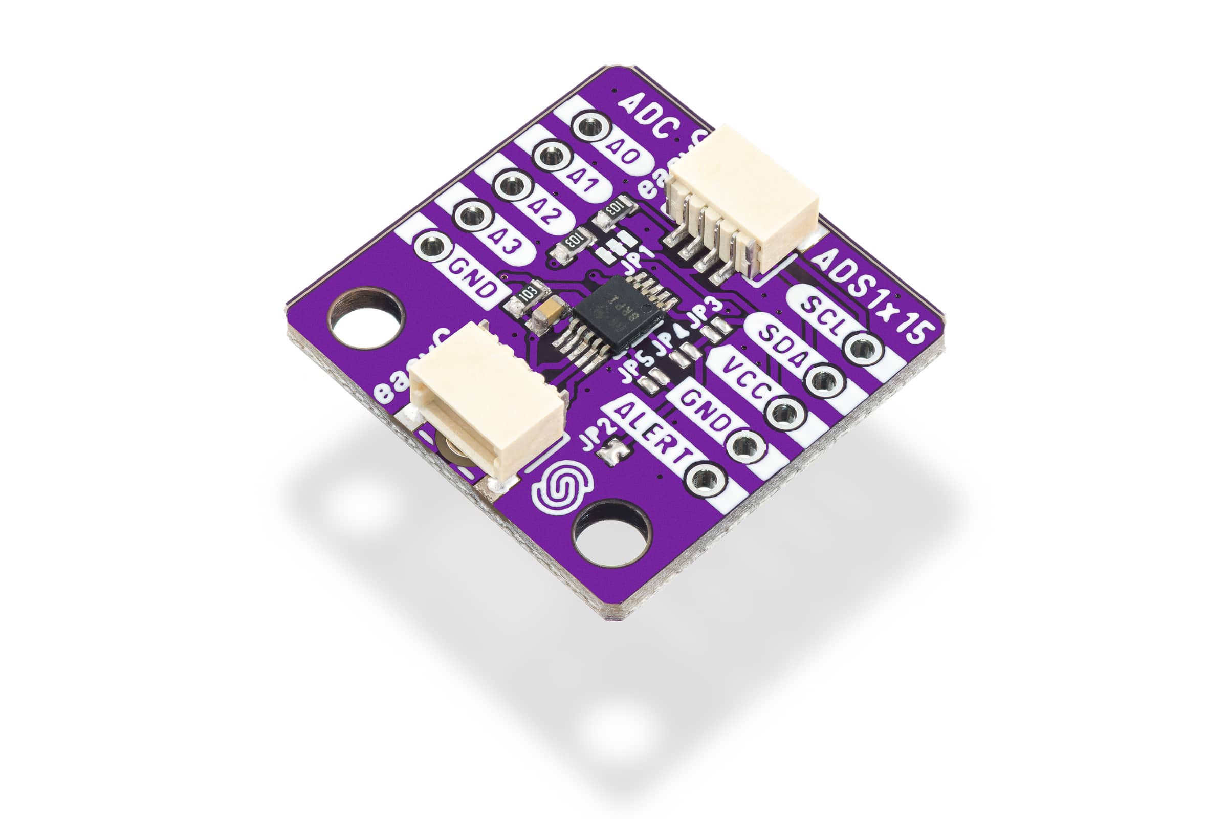

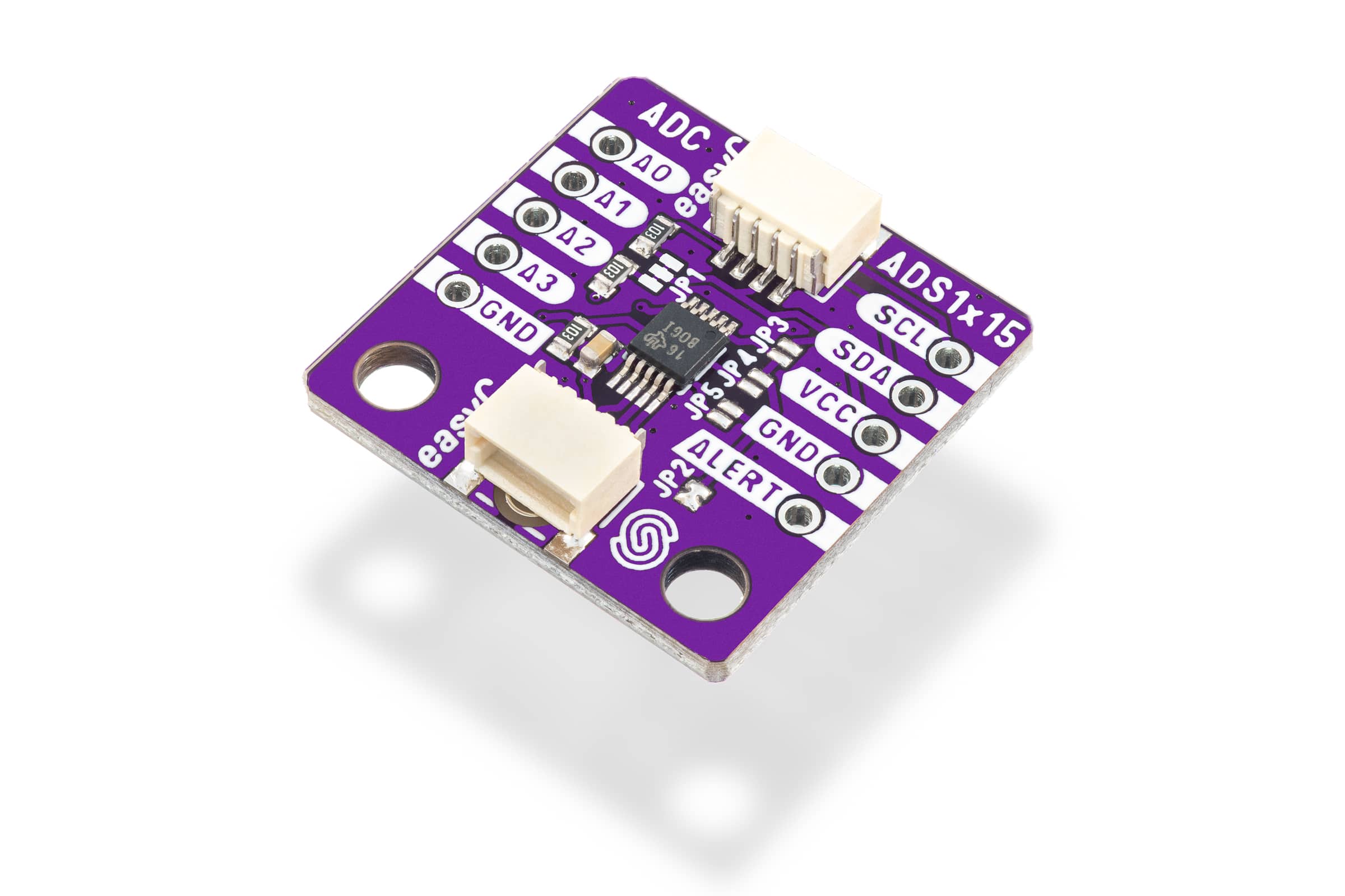

ADC 12-bit ADS1015
Which products does this documentation cover?​
ADC 12-bit ADS1015
ADC 12-bit ADS1015
333094
ADC 16-bit ADS1115
ADC 16-bit ADS1115
333095
Key Features​
  • Voltage: 3.3V
  • Resolution: 12-bit (ADS1015) / 16-bit (ADS1115)
  • Number of Channels: 4 single-ended or 2 differential
  • I2C Communication: Four pin-selectable addresses
  • Low Current Consumption: 150 μA (Continuous-Conversion Mode)
  • Programmable Data Rate: 128 SPS to 3.3 kSPS
  • Dimensions: 22 x 22 mm (0.9 x 0.9 inch)

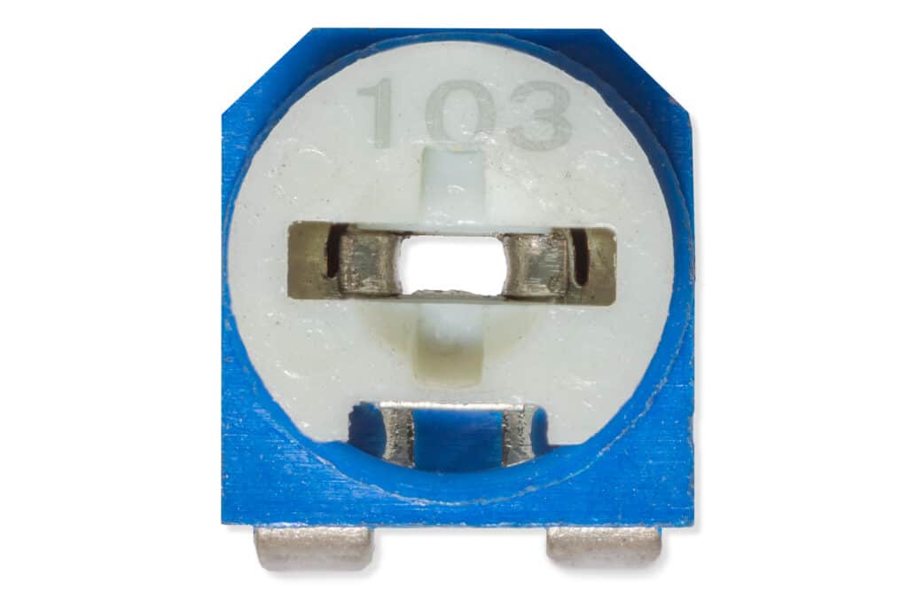

Potentiometer 10k
Potentiometer 10k
A potentiometer with adjustable resistance of 10k ohm that is compatible with breadboards. It can be used for various kinds of control, such as adjusting the intensity of LED lights.
