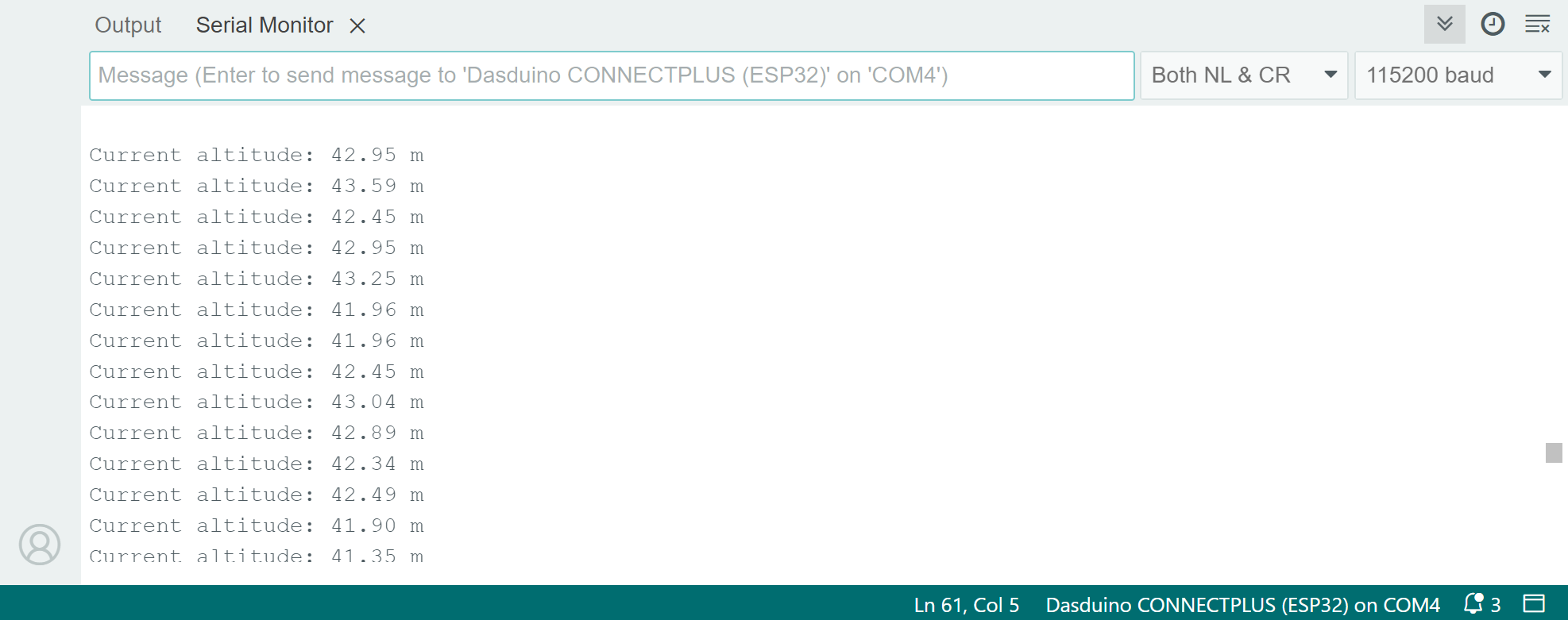

Serial.println("Current altitude: "+String(altitude)+" m");
Serial monitor altitude readings
Serial monitor
