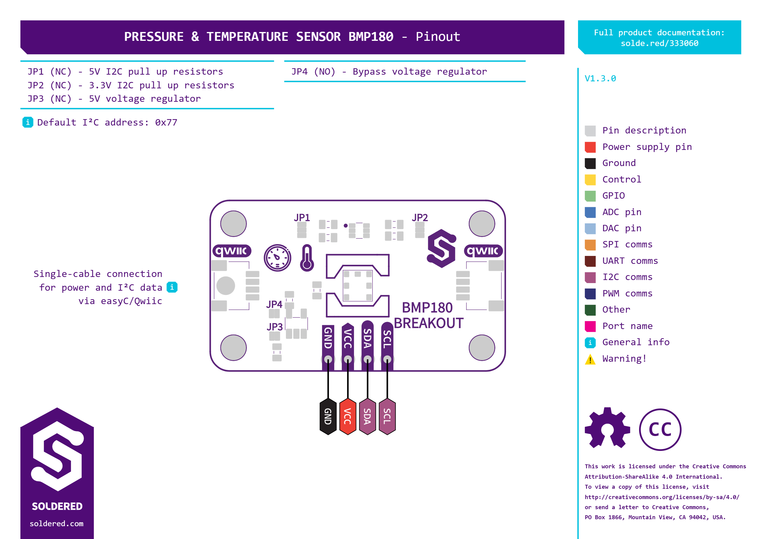

Pinout​
The pinout image for this board hasn't been generated yet! We're working on it!
This breakout board operates at 3.3V logic level, but includes an onboard regulator for 5V compatibility so it can be connected to both 3V3 and 5V logic boards!

Jumper Details​
Loading carousel...
JumperDefault StateFunction
JP2NC (Normally closed)Connects SDA/SCL pull-up resistors to 3.3V for I2C communication.
JP3NC (Normally closed)When connected, the voltage regulator is powered by 5V, stepping it down to 3.3V for the IC.
JP4NO (Normally open)When shorted, it bypasses the voltage regulator, allowing the board to be powered directly from 3.3V via headers. Ensure JP3 is disconnected if JP4 is connected.
