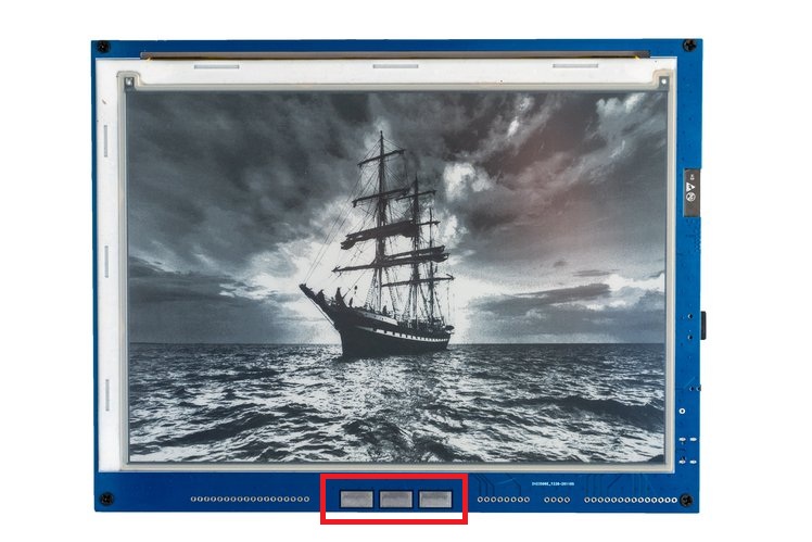

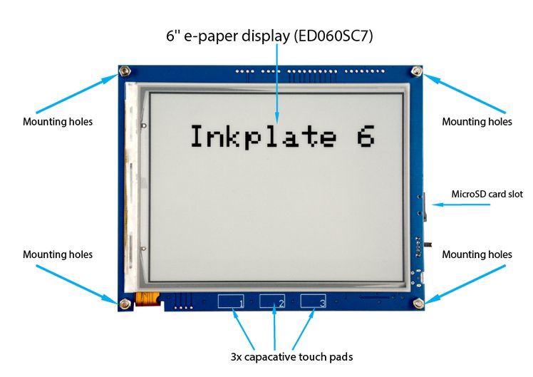

Older Touchpad Boards​
E-Radionica Inkplate 6​
Older inkplate 6 board
E-Radionica Inkplate 10​
