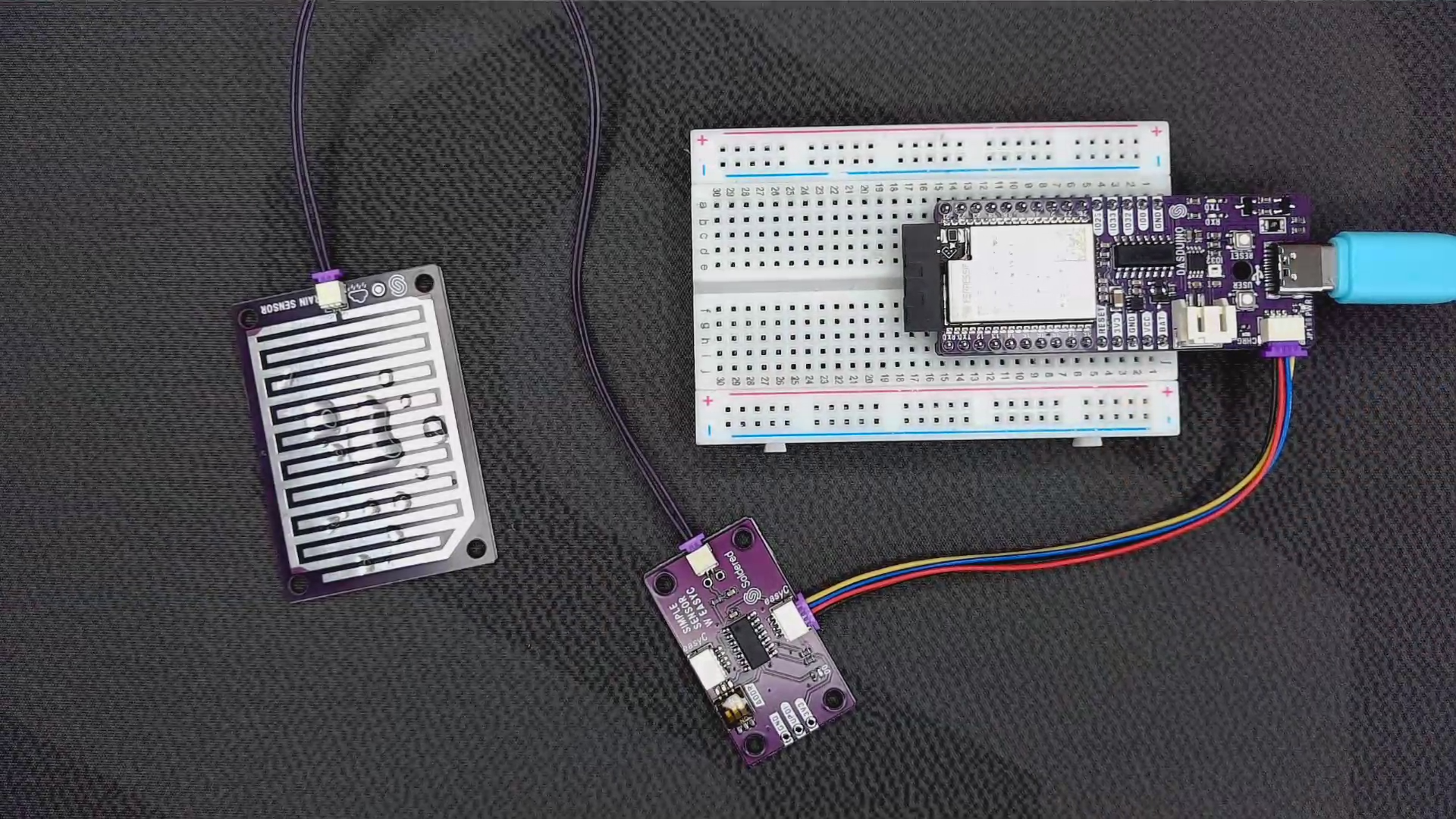

Sensor when rain is not present

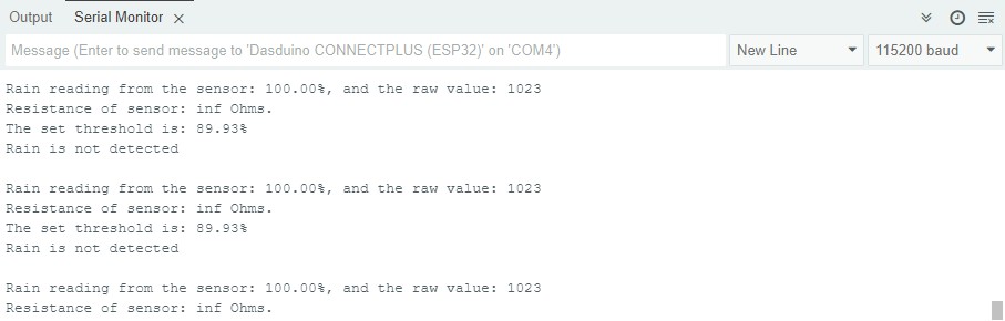

Serial Monitor output

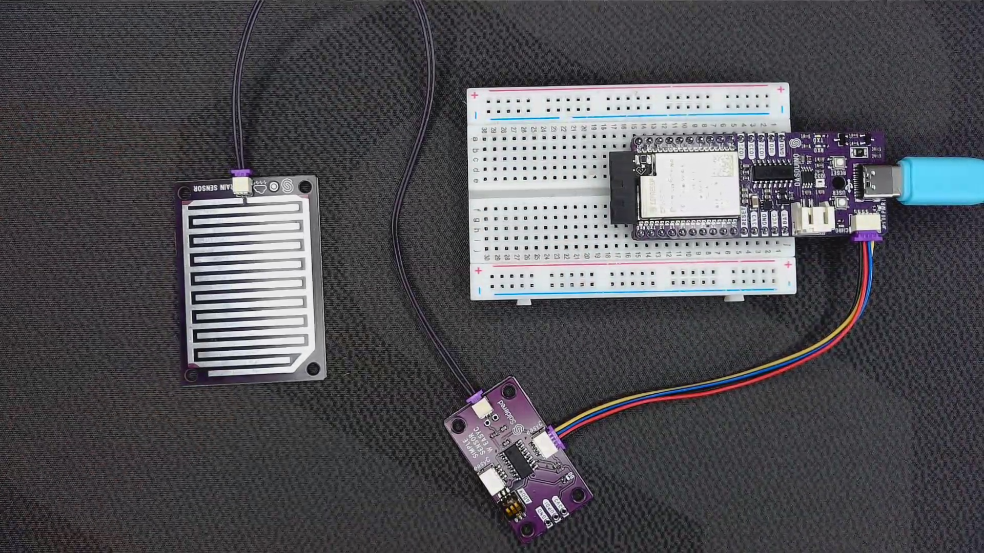

Sensor when rain is present
