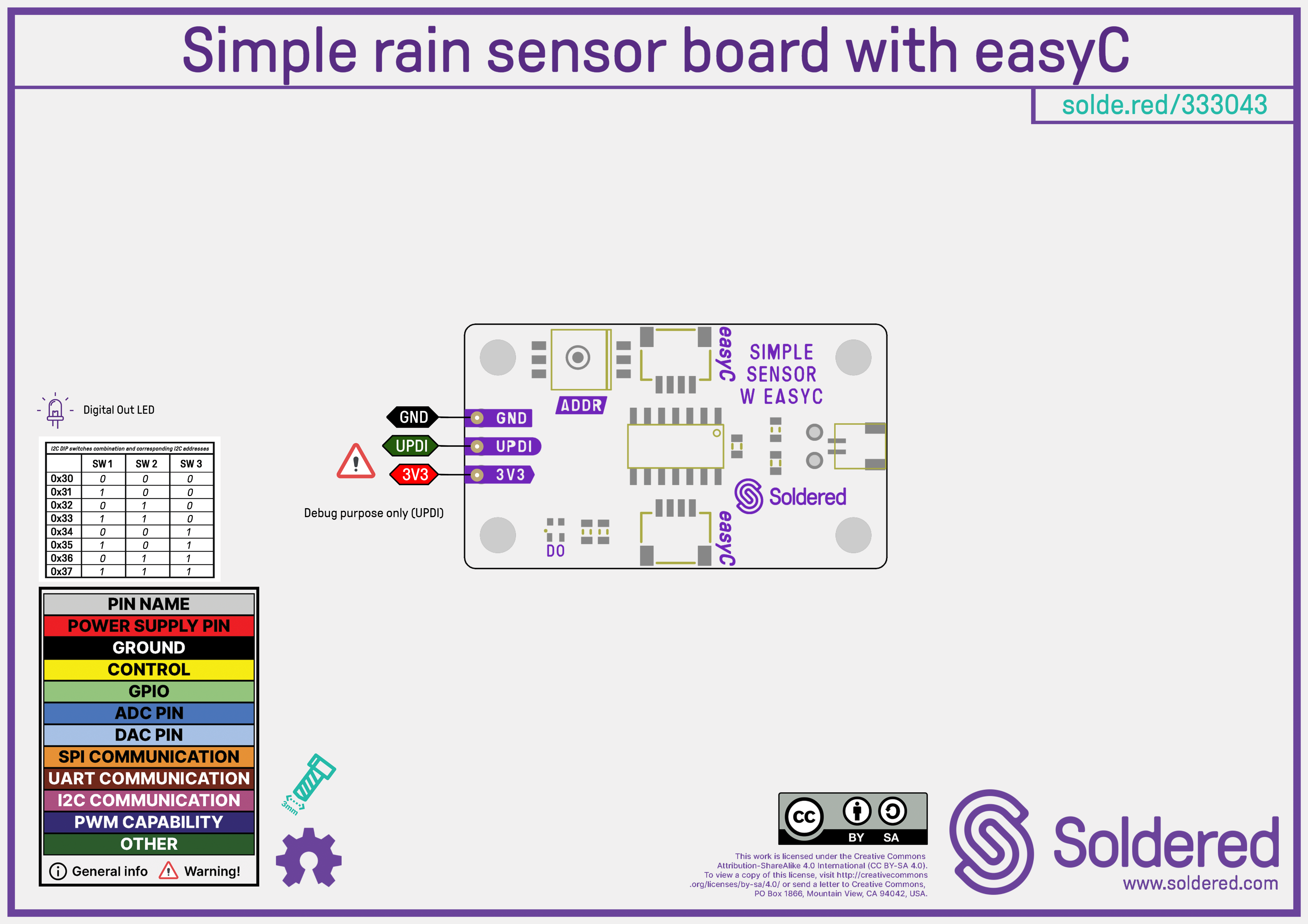

Pin details for Qwiic version​
For the Qwiic version, connection is achieved using a Qwiic connector.
Qwiic versions also contain UPDI headers for preprogramming the onboard ATTINY404 MCU, they are used only for debugging purposes.
Dimensions for Qwiic version​
  • Rain sensor Dimensions: 55 x 38 mm (2.2 x 1.5 inch)
  • Simple sensor Dimensions: 38 × 22 mm (1.5 × 0.9 inch)
  • Header Pin Holes: 1.5 mm

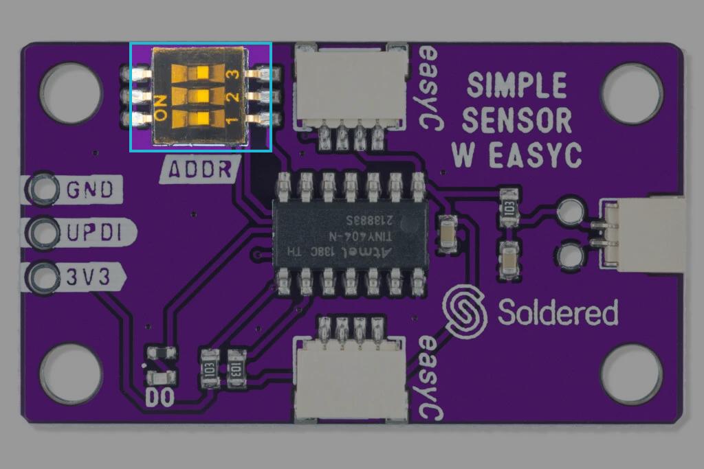

Address selection for Qwiic version​
This board contains hardware address switches. See below for instructions on how to change the breakout board's address.
Address Switches
AddressSW3SW2SW1
0x30000
0x31001
0x32010
0x33011
0x34100
0x35101
0x36110
0x37111
