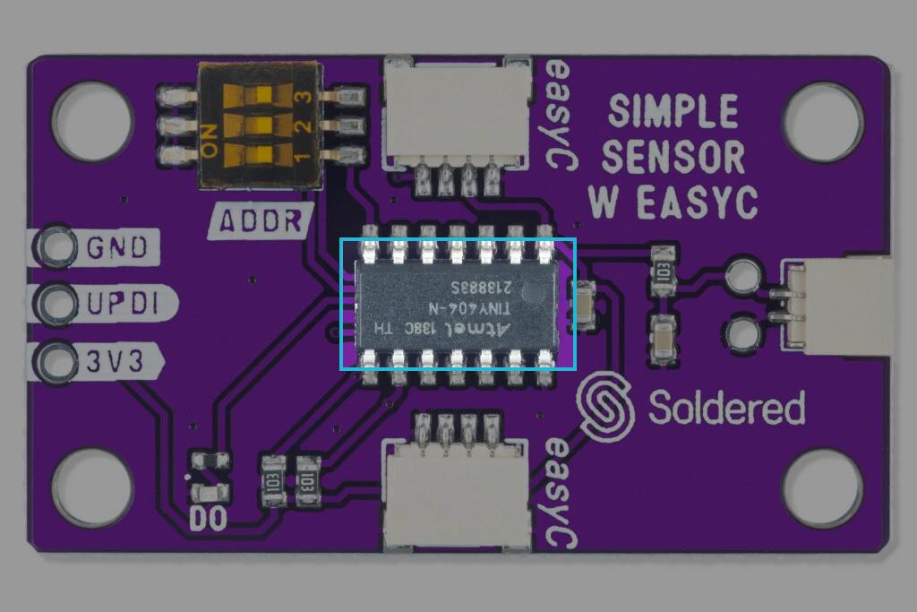

ATTiny404 MCU on board of Qwiic version

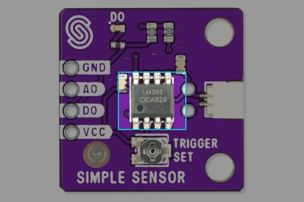

LM393 on board of regular version

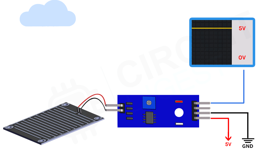

The rain sensor uses an external breakout board that contains two nickle-plated lines that create an open circuit. When any moisture or water drops are present, the circuit gets closed, which alters the internal voltage. The sensor includes an IC to provide additional functionality and simplify its operation.
How the rain sensor works

Qwiic versions of the product use onboard ATTINY404 MCU to implement I2C communication. Breakout board operates with a default I2C address of 0x30 but can be changed with onboard switches,to change breakout board's address, check the Address selection. When detected, ATTINY404 recives data from sensor and passes it to the main MCU using I2C data line. To check in detail how to ATTINY404 is preprogrammed, check firmware github page.
