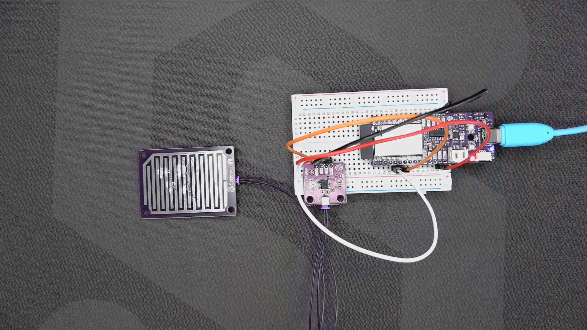

Sensor when rain is not present

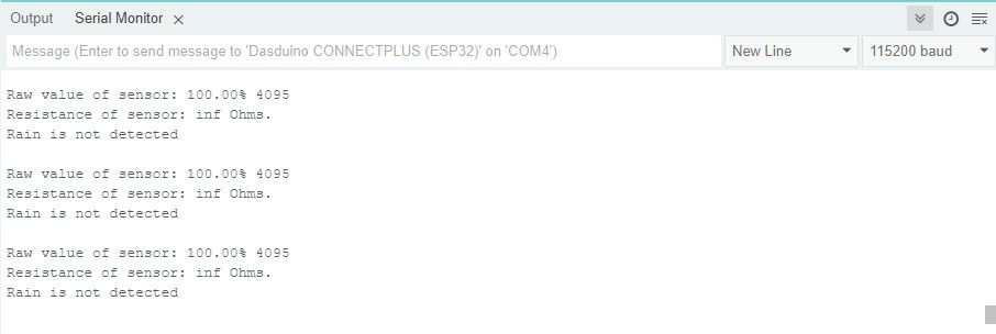

Serial Monitor output

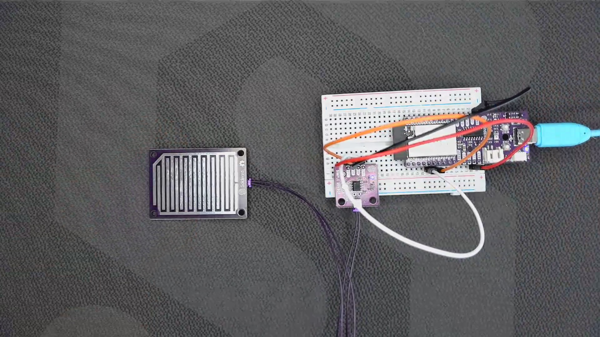

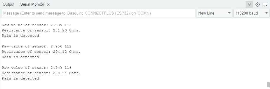

Sensor when rain is present
