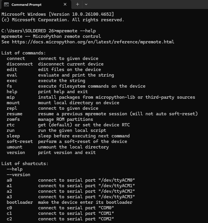

To verify it's working:
mpremote --help
cmdhelpoutput
Expected output when using the --help command.
