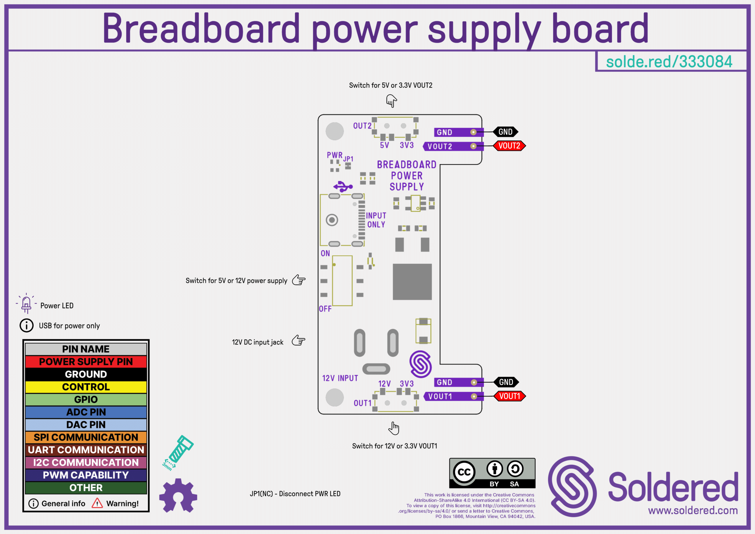

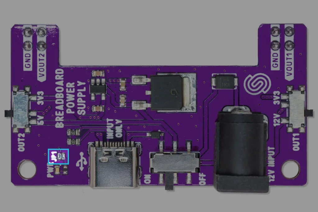

This board contains a hardware jumper; see below for its location and function:
Breadboard power jumper location
JumperDefault StateFunction
JP1NC (Normally closed)When shorted, it provides power to the onboard power LED
Switch Details​
This board contains switches that control the voltage output; see below for their locations and functions:
Loading carousel...
SwitchFunction
S1Switches power to the board on or off
S2Switches between a 12V or 3V3 output on VOUT1 pin
S3Switches between a 5V or 3V3 output on VOUT2 pin
