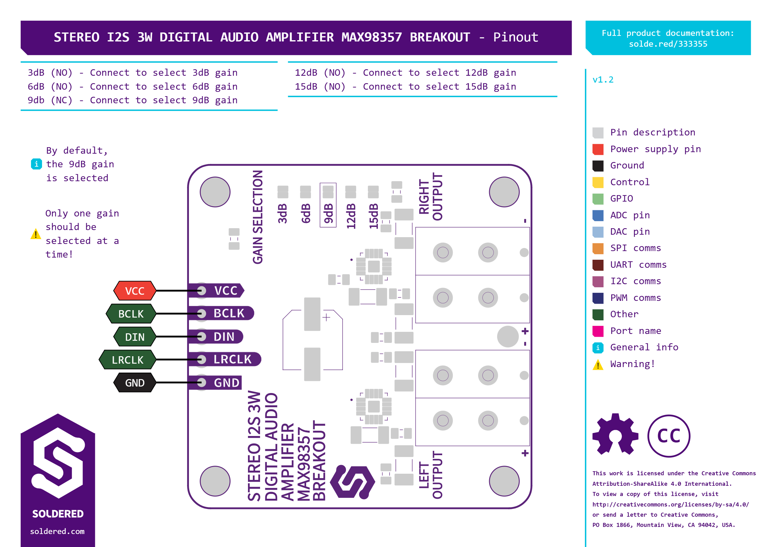

Pinout​
Pinout image
Click here for a high reoslution image of the pinout.
Pin details​
VCCPowerSupply voltage (supports 3.3V and 5V)
BCLKBit ClockBit clock signaling when to read each bit of audio data
DINData InDigital input signal (audio data)
LRCLKLeft-Right ClockLeft/Right clock for selecting left or right audio channel
GNDGroundGround
LEFT OUTPUTOutputLeft channel speaker output
RIGHT OUTPUTOutputRight channel speaker output

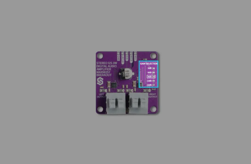

Gain selection jumpers​
This board contains hardware gain selection jumpers for optimizing output levels for different speakers and applications:
