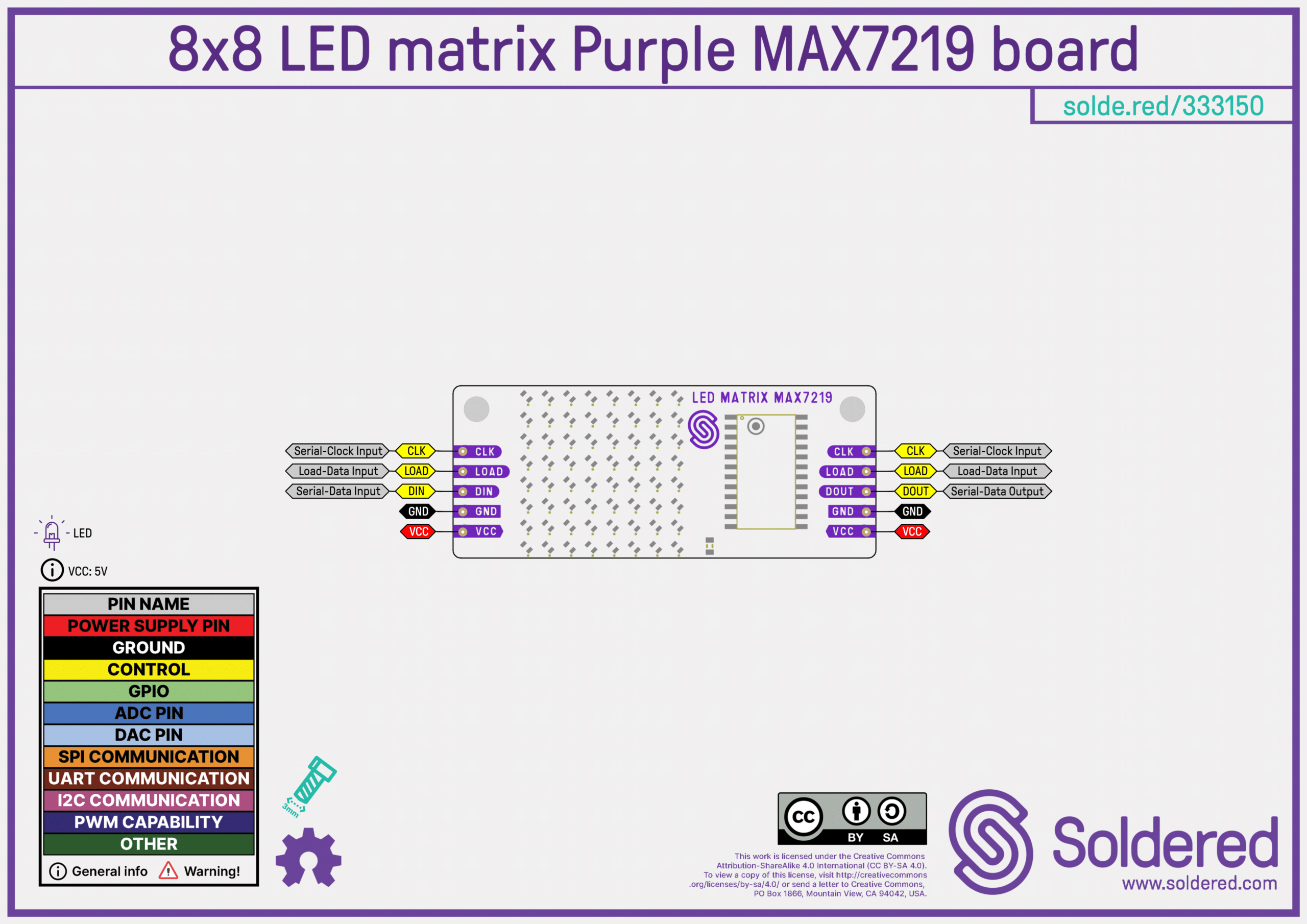

Pinout​
Pinout
Pin details​
VCCPower5V Supply voltage.
DOUTDataSerial-Data Output.
LOADDataLoad-Data Input.
DINDataSerial-Data input.
CLKDataSerial-Clock Input.
Dimensions​
  • Board Dimensions: 54 x 22 mm (2.1 x 0.9 inch)
  • Header Pin Holes: 1.5 mm
