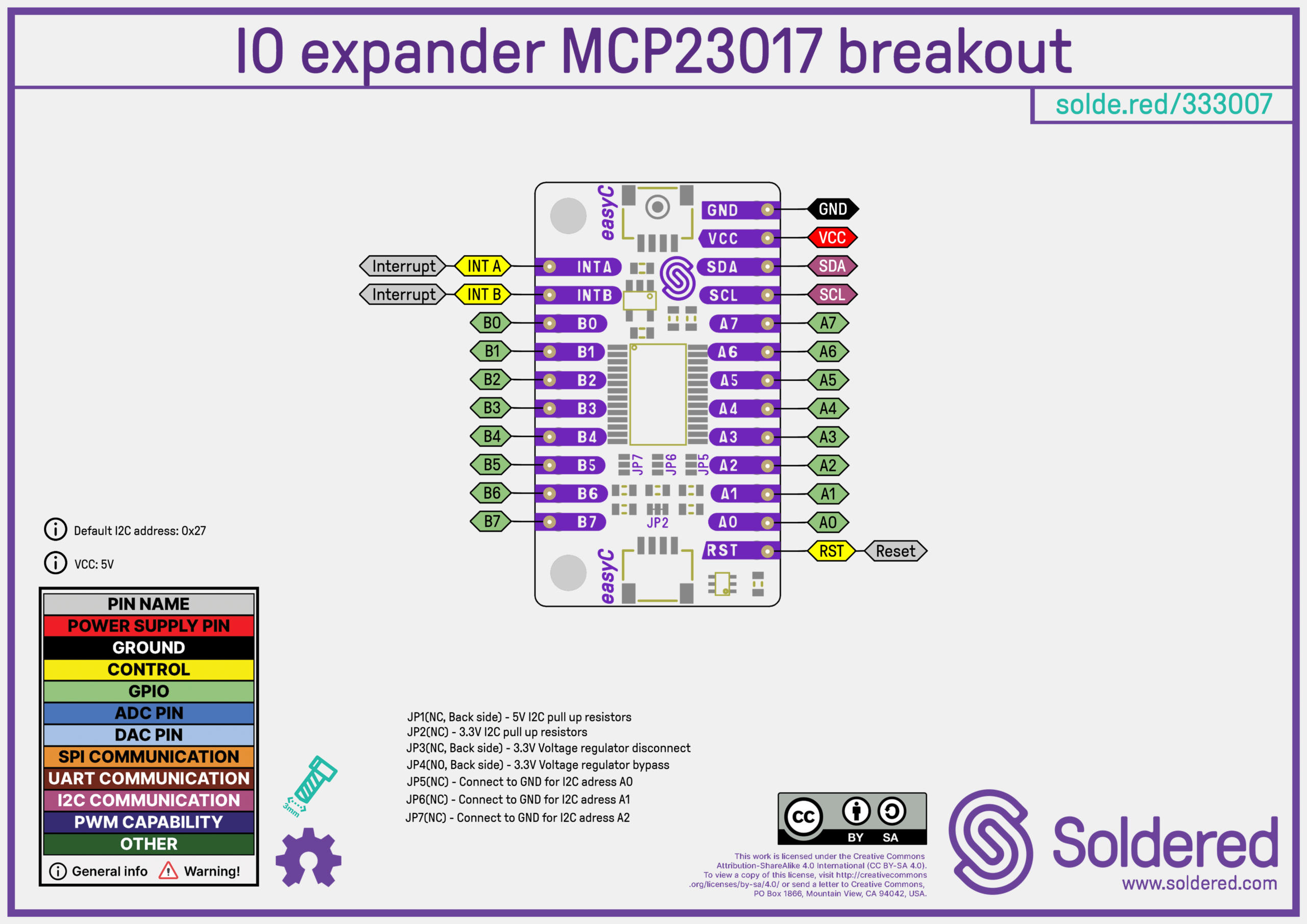

Pinout
RSTResetReset pin.
A0-A7I/OA channel digital I/O.
B0-B7I/OB channel digital I/O.
INT AInterruptA channel interrupt pin.
INT BInterruptB channel interrupt pin.
Qwiic (formerly easyC)​
EasyC/qwiic cable
Jumper Details​
This board contains hardware jumpers, see below for their locations and functions:
Loading carousel...
JumperDefault StateFunction
JP2NC (Normally closed)Connects SDA/SCL pull-up resistors to 3.3V for I2C communication.
JP3NC (Normally closed)Disconnects the 3.3V voltage regulator.
JP4NO (Normally open)When closed, bypasses 3.3V voltage regulator.
JP5NC (Normally closed)When connected to GND, sets the I2C address to 0xA0.
JP6NC (Normally closed)When connected to GND, sets the I2C address to 0xA1.
JP7NC (Normally closed)When connected to GND, sets the I2C address to 0xA2.
