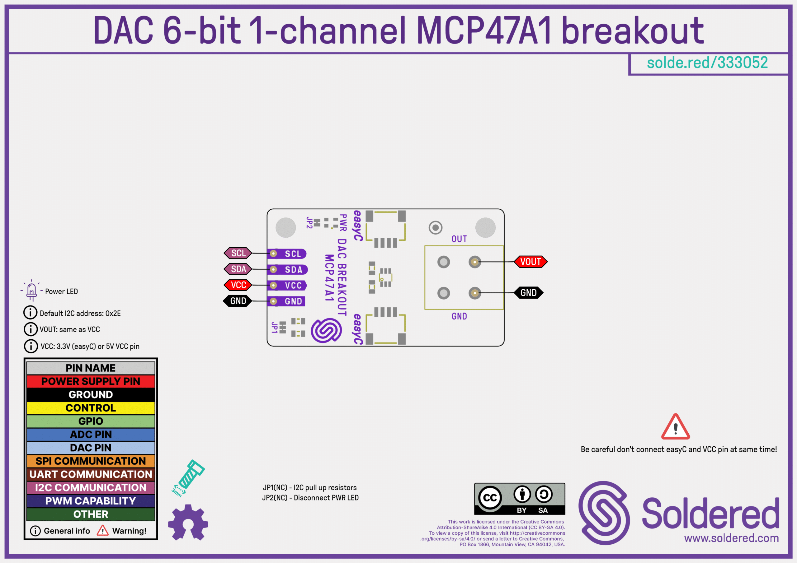

MCP47A1 - Hardware details
Pinout
VOUTVoltage outputOutputs the converted voltage.
Qwiic (formerly easyC)​
EasyC/qwiic cable
Jumper Details​
This board contains hardware jumpers. See below for their locations and functions:
Loading carousel...
JumperDefault StateFunction
JP1NC (Normally closed)Connects SDA/SCL pull-up resistors to VCC for I2C communication.
JP2NC (Normally closed)When connected, provides power to the power LED.
Dimensions​
  • Board Dimensions: 38 x 22 mm (1.5 x 0.9 inches)
  • Header Pin Holes: 1.5 mm
