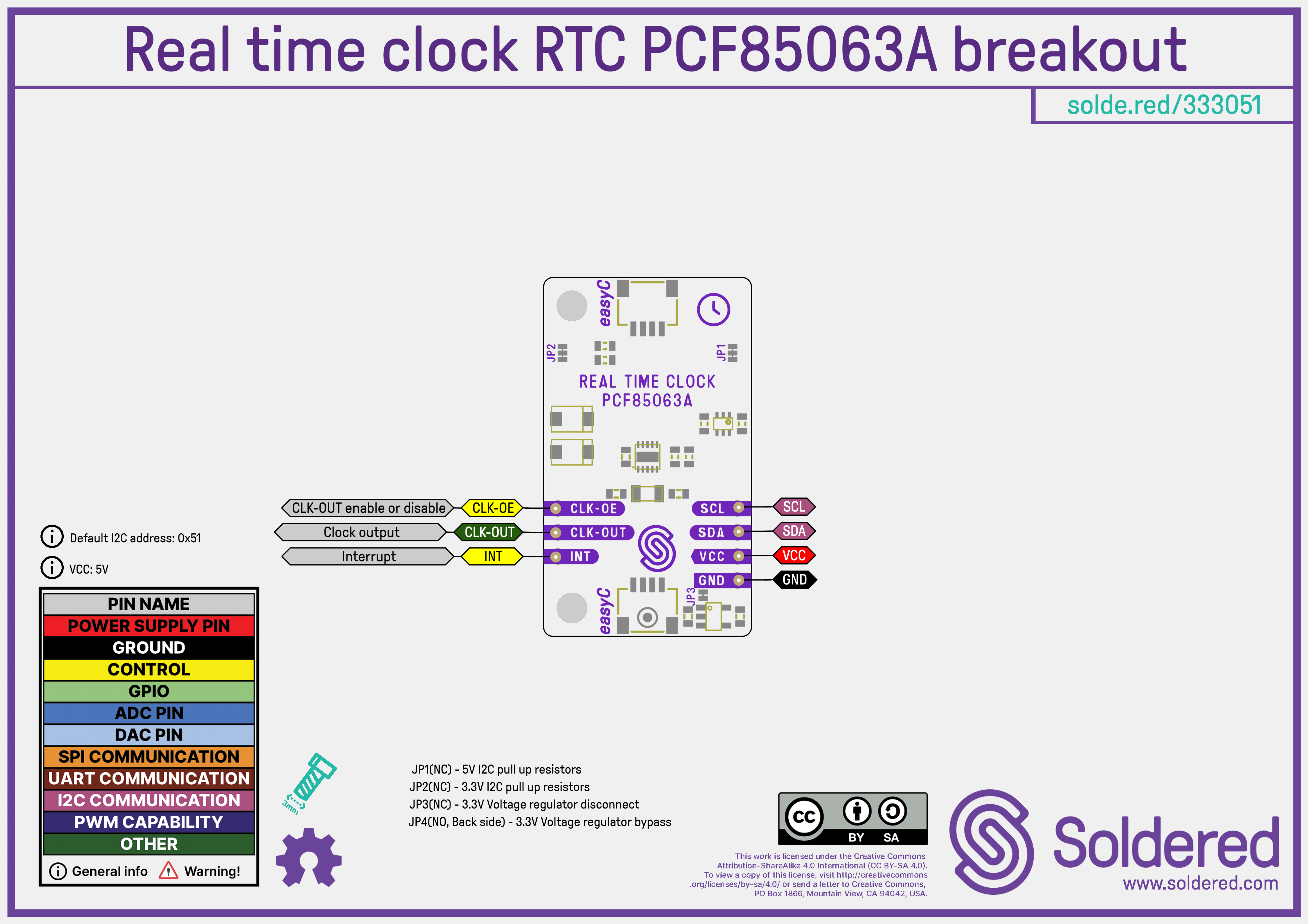

Pinout​
Pinout
Pin details​
CLK-OEClock output enableEnables the clock output pin when the pin is set to HIGH.
CLK-OUTClock outputSends square wave signals at a speed defined by the user.
INTInterruptSends a hardware interrupt.
Qwiic (formerly easyC)​
EasyC/qwiic cable
Jumper details​
Loading carousel...
JumperDefault StateFunction
JP2NC (Normally closed)Connects SDA/SCL pull-up resistors to 3.3V for I2C communication.
JP3NC (Normally closed)Connects the VCC pin to a 5V-to-3V3 voltage regulator IC.
JP4NO (Normally open)When connected, bypasses the voltage regulator on the VCC pin, allowing 3V3 to be connected instead of 5V. Make sure JP3 is disconnected if JP4 is connected.
