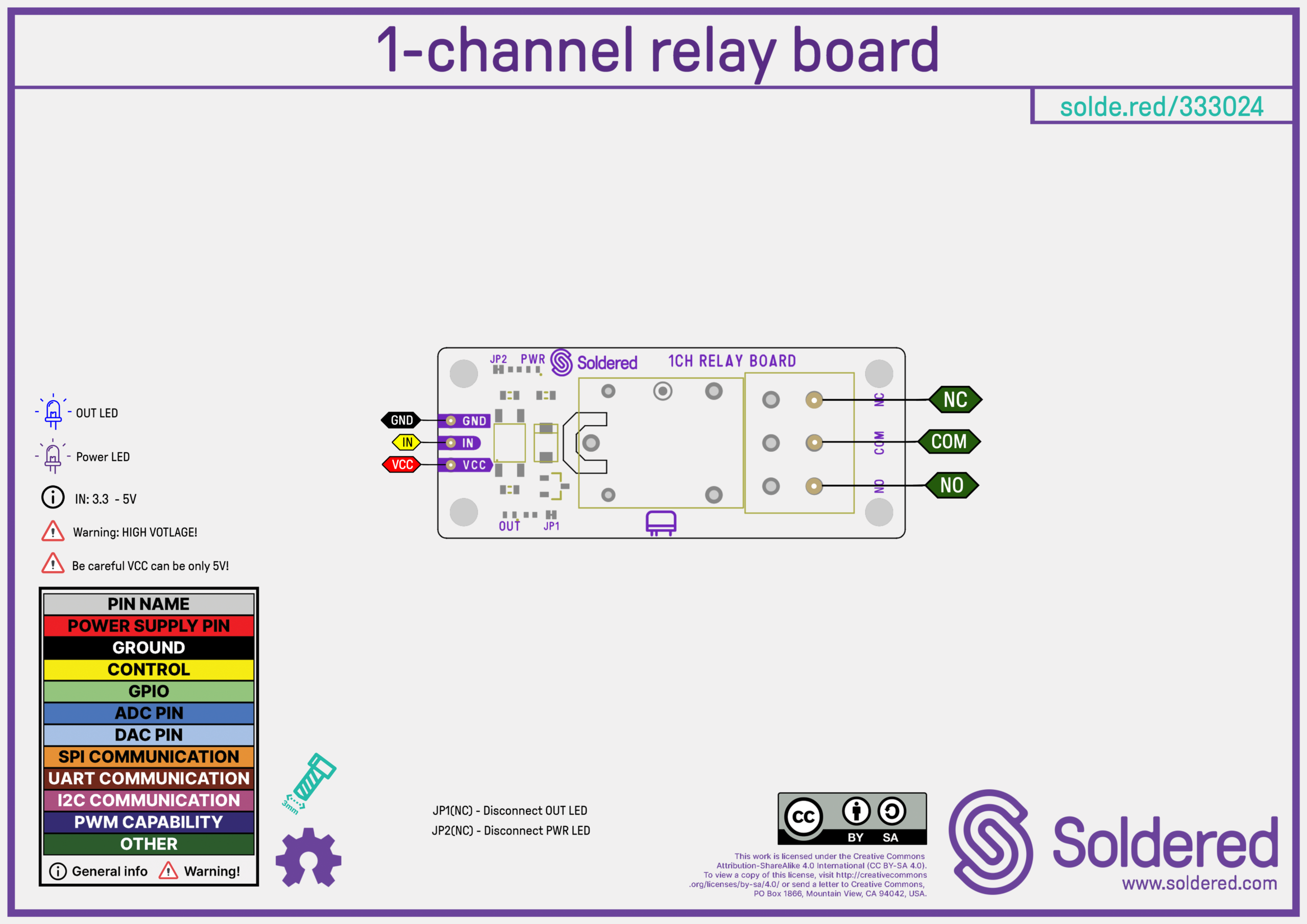

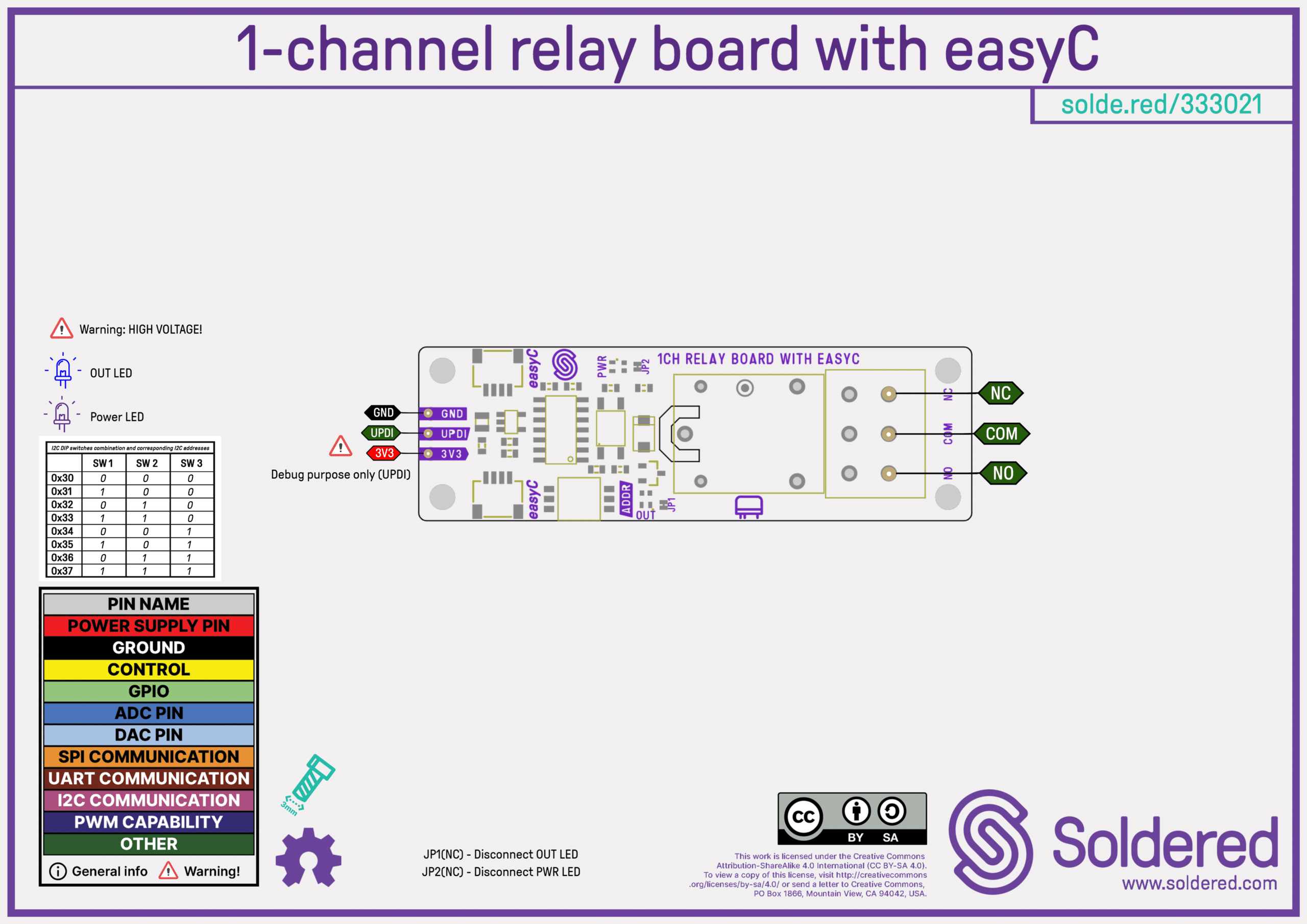

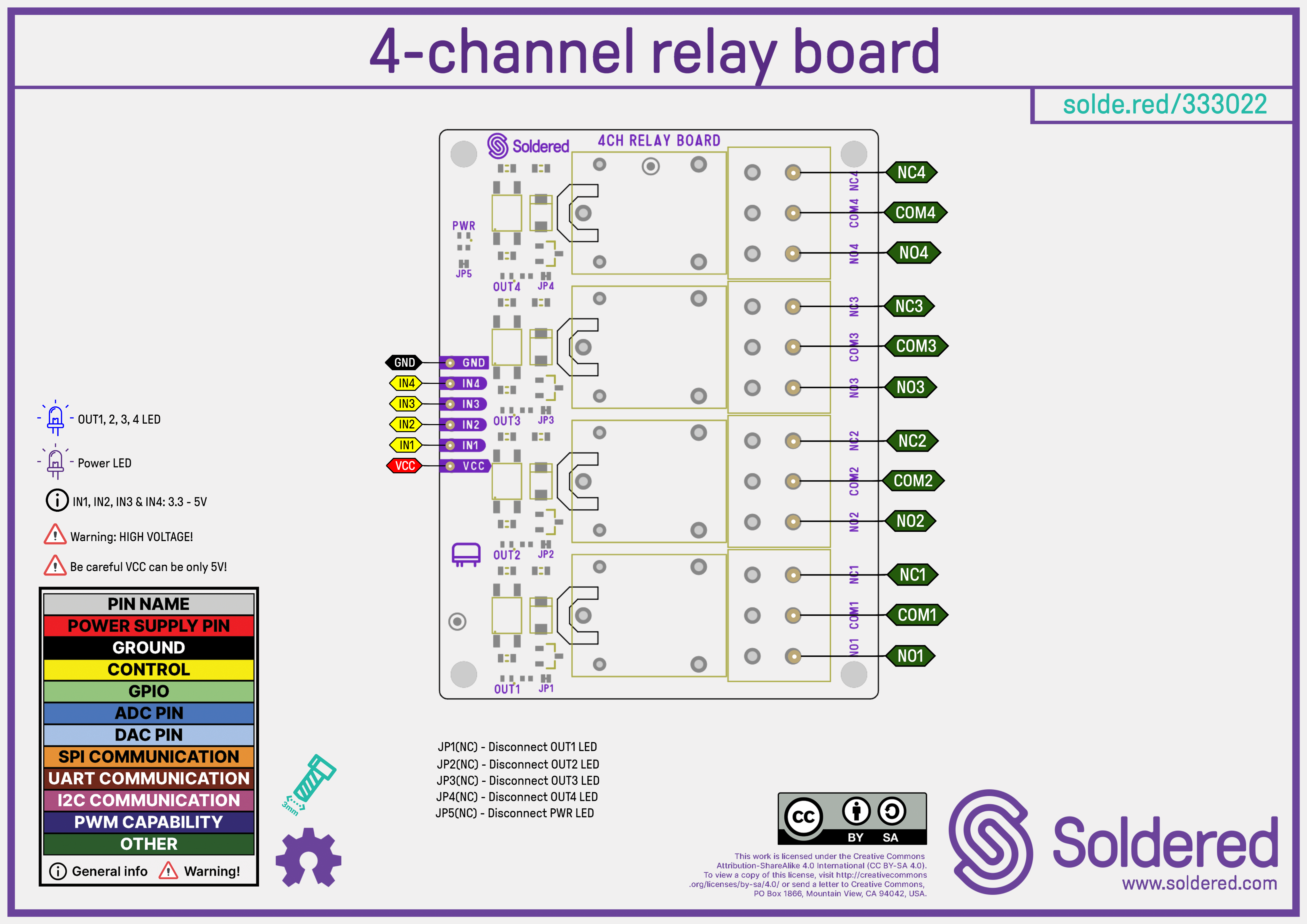

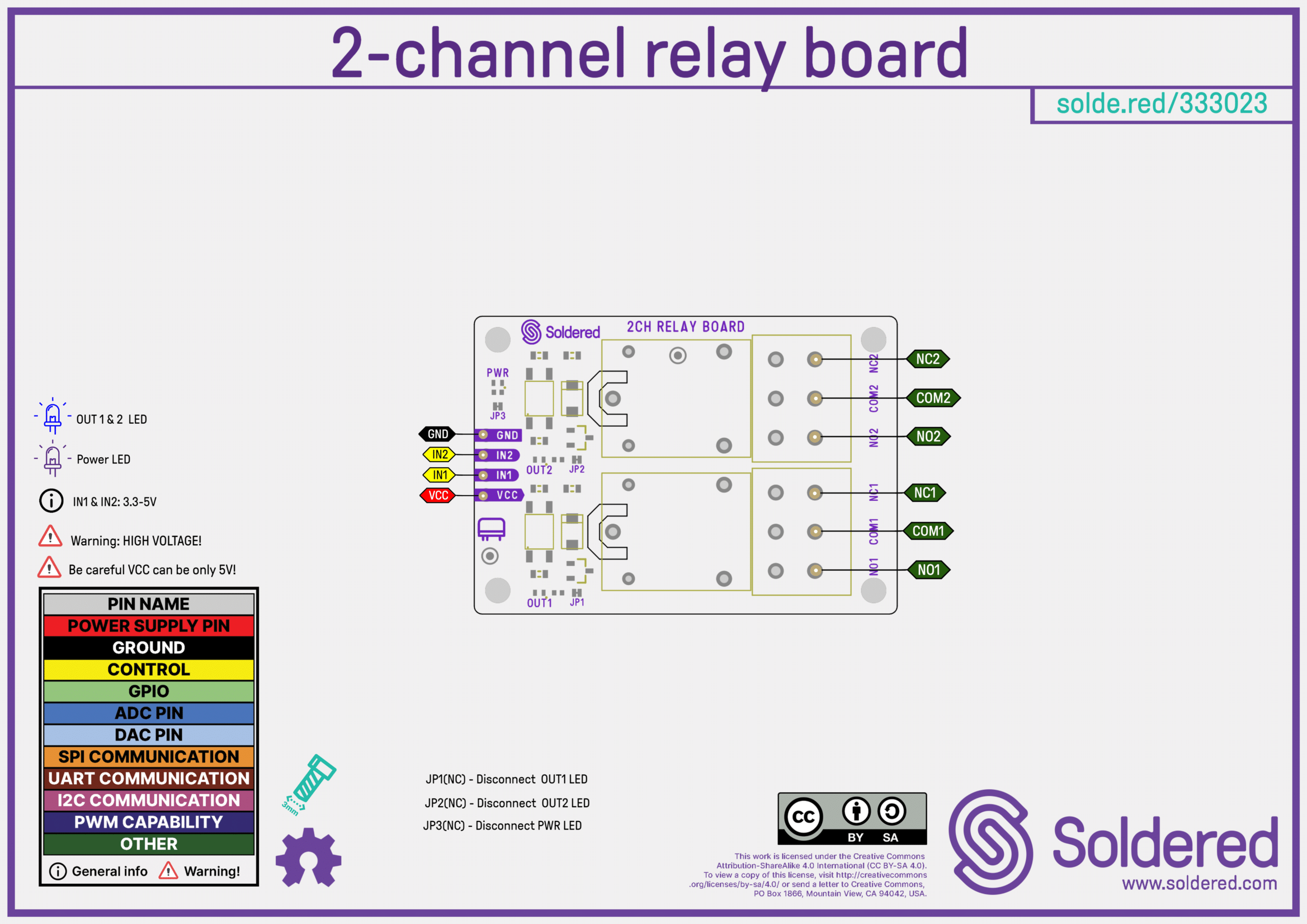

Pinout​
Pinout
Pinout
Pinout
Pinout
Pin details for regular version​
INDataData line for digital communication
The IN pins can work at 3V3 or 5V logic
Qwiic (formerly easyC)​
EasyC/qwiic cable
This board has Qwiic-compatible version! Just plug it into your board using a Qwiic/easyC/STEMMA QT cable and start coding!

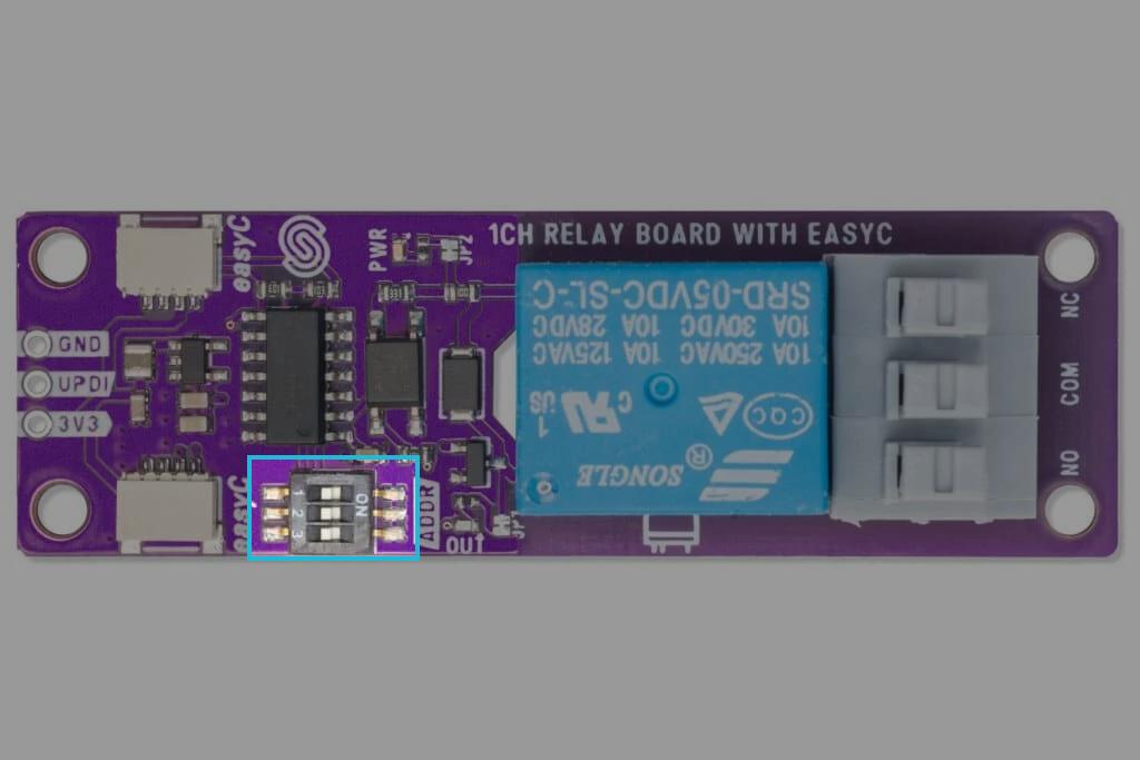

Address selection for Qwiic version​
This board contains hardware address switches, see below how to change circuit board's address:
Pinout
AddressSW3SW2SW1
0x30000
0x31001
0x32010
0x33011
0x34100
0x35101
0x36110
0x37111
