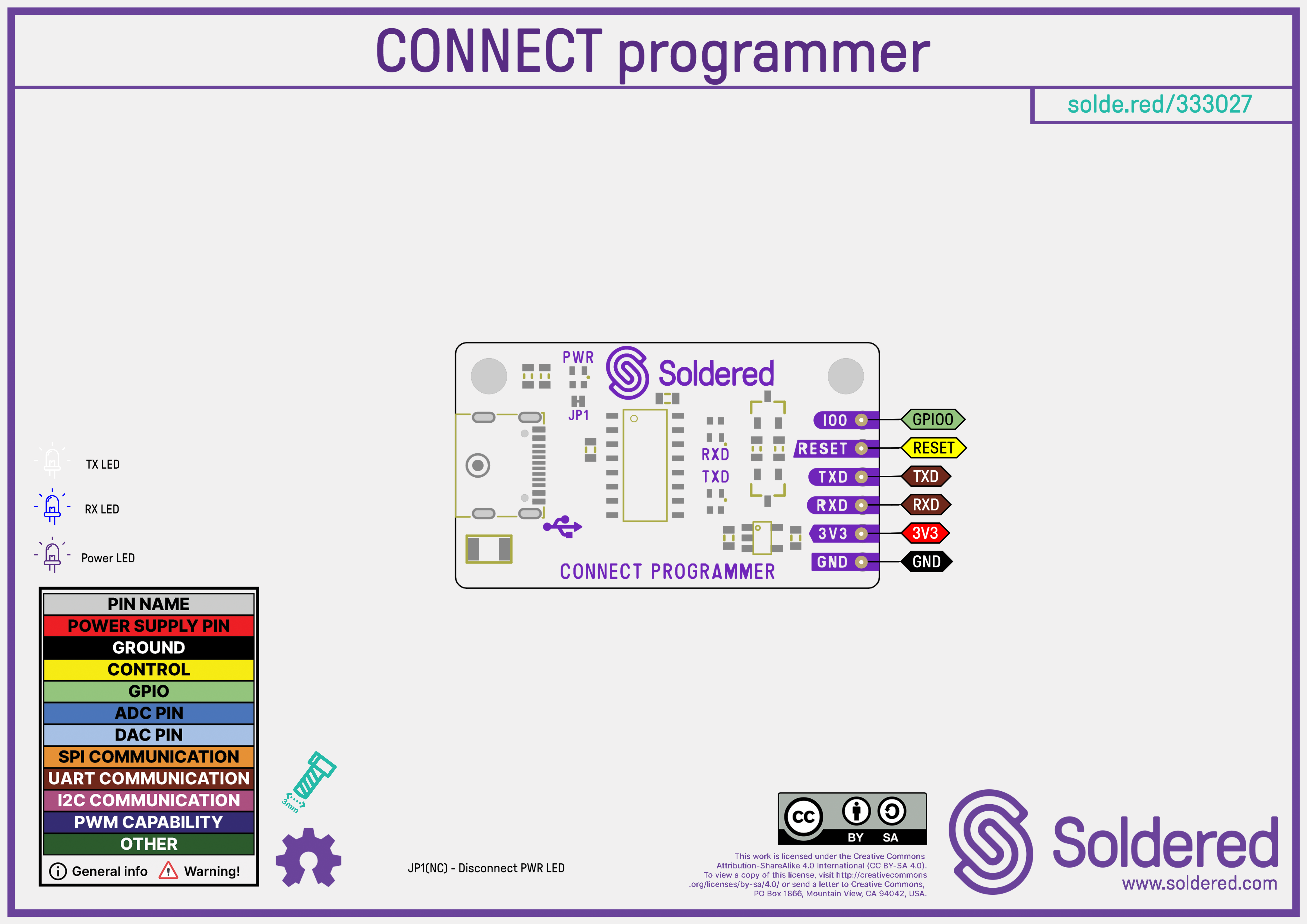

Pinout​
CONNECT programmer pinout
Pin details​
IO0OutputPin used to set the ESP into bootloader mode
RESETOutputResets the ESP when set to HIGH
TXDTransceiverTransceiver pin for UART communication
RXDReceiverReceiver pin for UART communication
3V3PowerProvides 3V3 to the ESP
GNDGroundConnects to the GND pin of the ESP
Dimensions​
  • Board Dimensions: 38 × 22 mm (1.5 × 0.9 inch)
  • Header Pin Holes: 1.5 mm

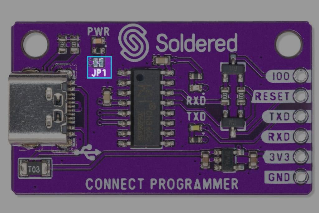

Jumper Details​
Jumper 1
JP1
JumperDefault StateFunction
JP1NC (Normally closed)Connects the onboard Power LED to 3V3
