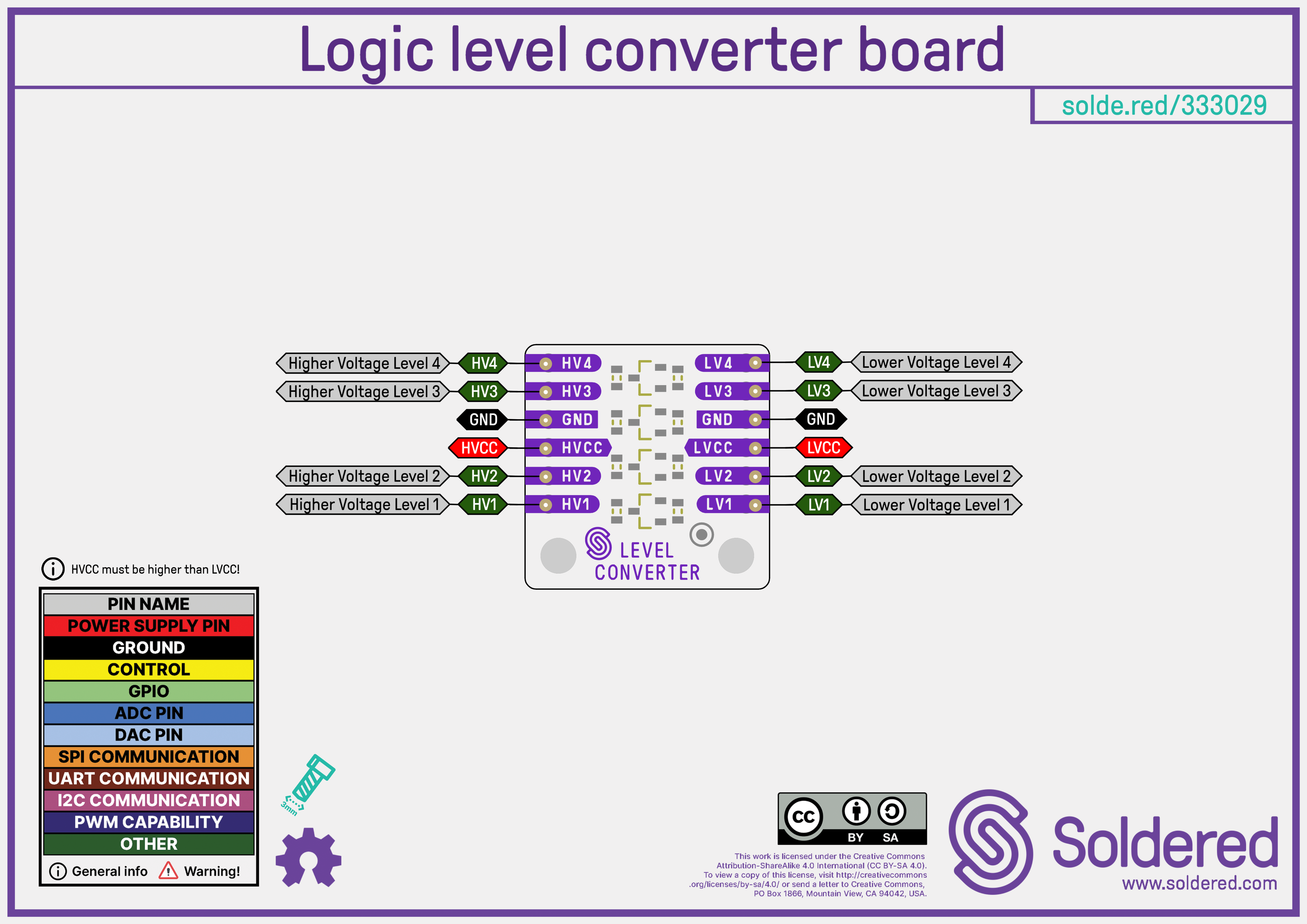

Pinout​
Logic Level Converter pinout diagram
Pin Details​
GNDGroundCommon ground for both high and low voltage sides.
HVCCHigh Voltage PowerSupply voltage for the high-voltage side (typically 5V).
LVCCLow Voltage PowerSupply voltage for the low-voltage side (typically 3.3V).
HV1 - HV4High Voltage PinsHigh-voltage side signal pins (typically 5V logic).
LV1 - LV4Low Voltage PinsLow-voltage side signal pins (typically 3.3V logic).
Ensure that GND is connected to both the high and low voltage grounds to establish a common reference for signals.
