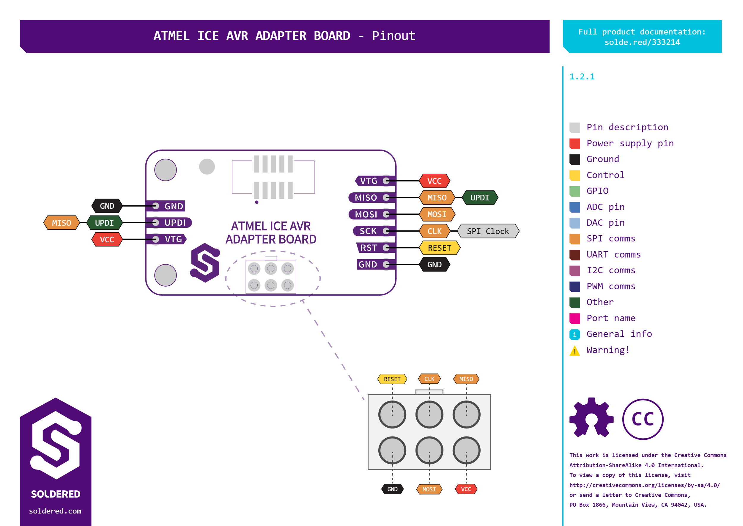

Pinout​
MakerICE AVR pinout
Pin details​
GNDGroundConnects to the GND pin of the ESP
UPDIProgram and Debug InterfacePin used for programming and debugging the AVR MCU
VTGPowerProvides 5V to the MCU
MISOSPI CommunicationSPI Master in Slave Out pin
MOSISPI CommunicationSPI Master Out Slave In pin
SCKSPI CommunicationSPI Clock pin
RSTResetReset pin
Dimensions​
  • Board Dimensions: 38 x 22 mm (1.5 x 0.8 inch)
  • Header Pin Holes: 1.5 mm
