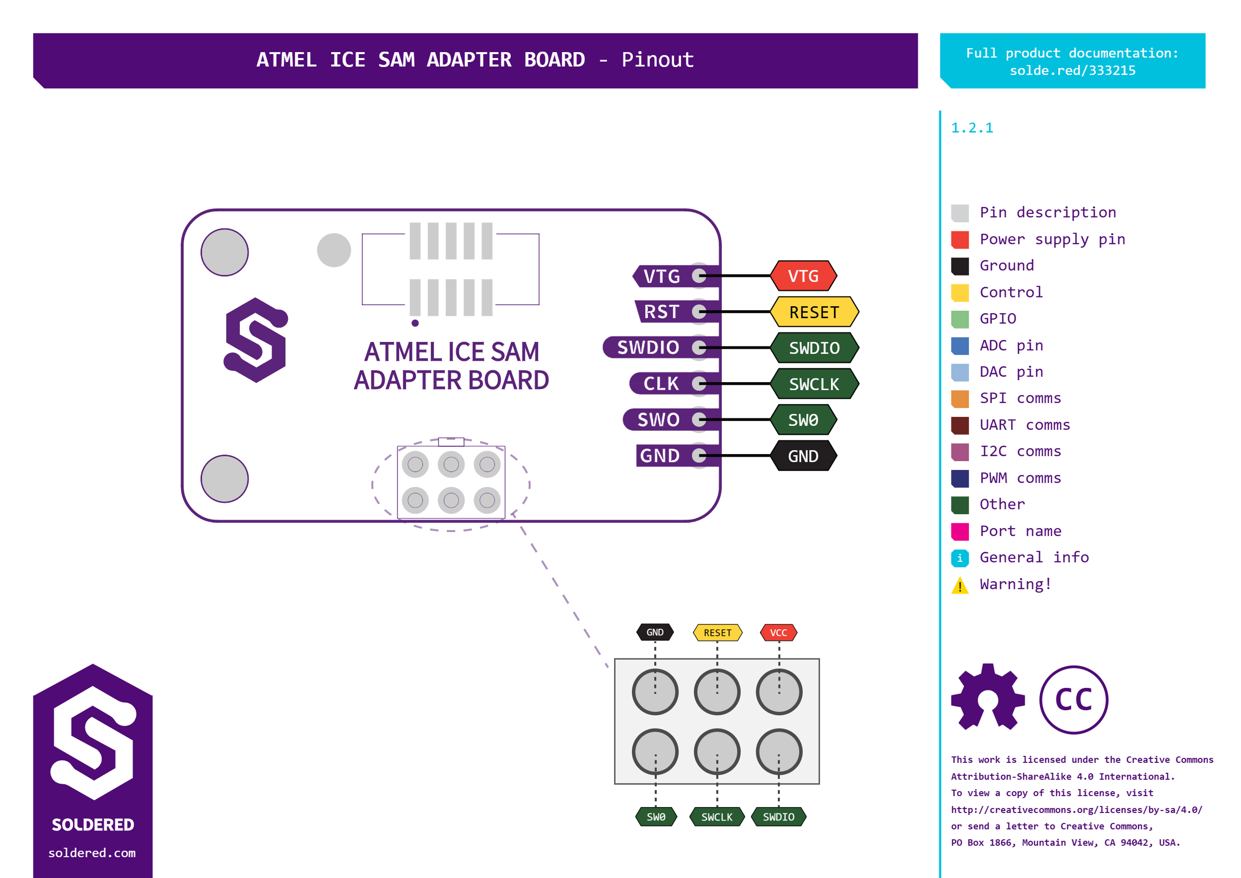

Pinout​
Pinout
Pin details​
VTGPowerProvides 5V to the MCU
RSTResetReset pin
SWDIODataSerial Wire Debug Data pin
CLKClockClock pin
SWODataSerial Wire Output
GNDGroundConnects to the GND pin of the ESP
