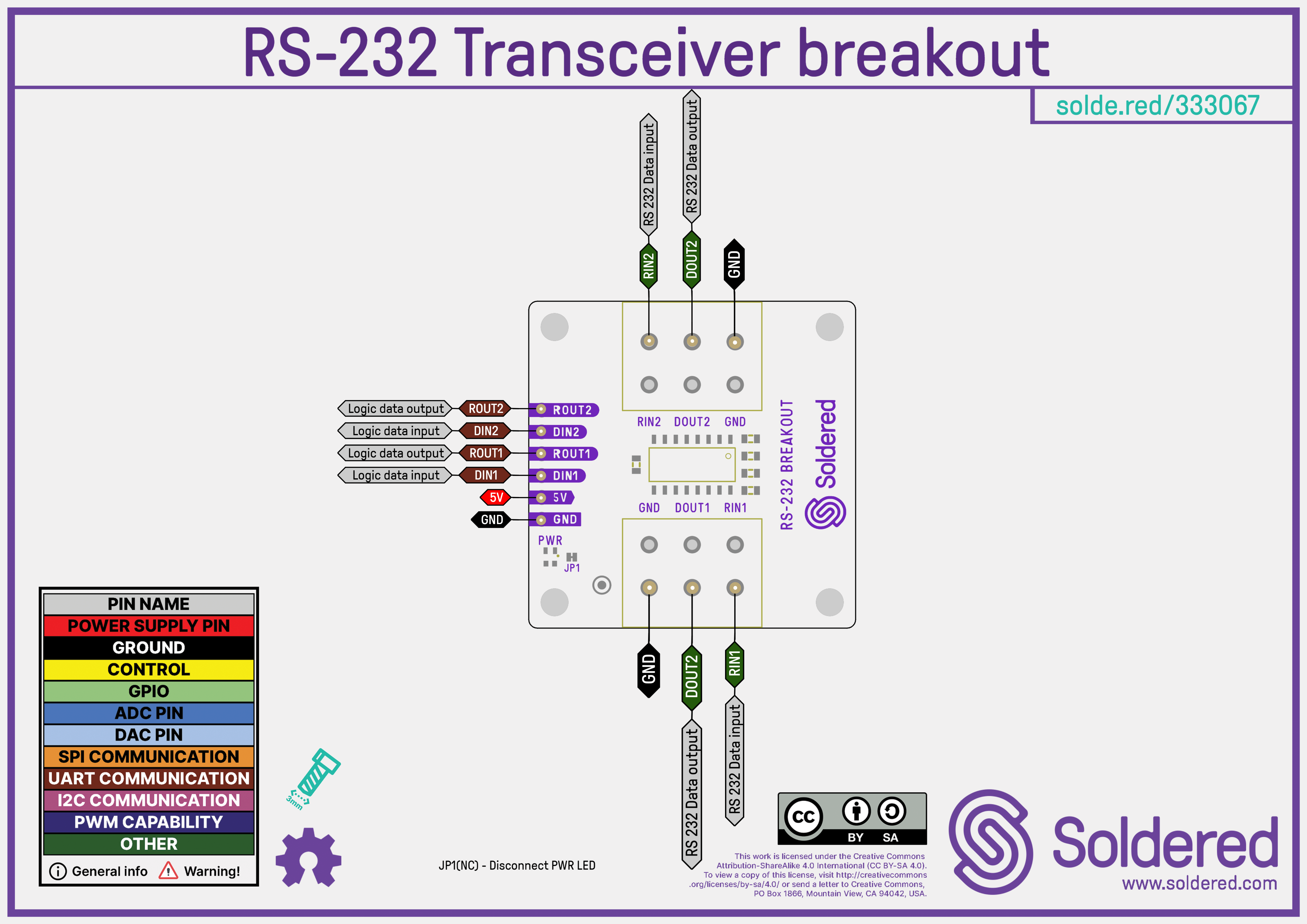

Pinout​
RS-232 transceiver pinout diagram
Pin Details​
ROUT2RS-232 ReceiveReceives data from the RS-232 device (Channel 2).
DIN2TTL TransmitSends data from the microcontroller to the RS-232 device (Channel 2).
ROUT1RS-232 ReceiveReceives data from the RS-232 device (Channel 1).
DIN1TTL TransmitSends data from the microcontroller to the RS-232 device (Channel 1).
5VSupply VoltagePower input for the board (3.3V to 5.5V).
GNDGroundCommon ground for both RS-232 and TTL/CMOS sides.
  • VCC Range: 3.3V - 5.5V
  • RS-232 Voltage Levels: ±3V to ±15V
Ensure that GND is connected between both the RS-232 device and TTL/CMOS device to establish a common reference for signals.

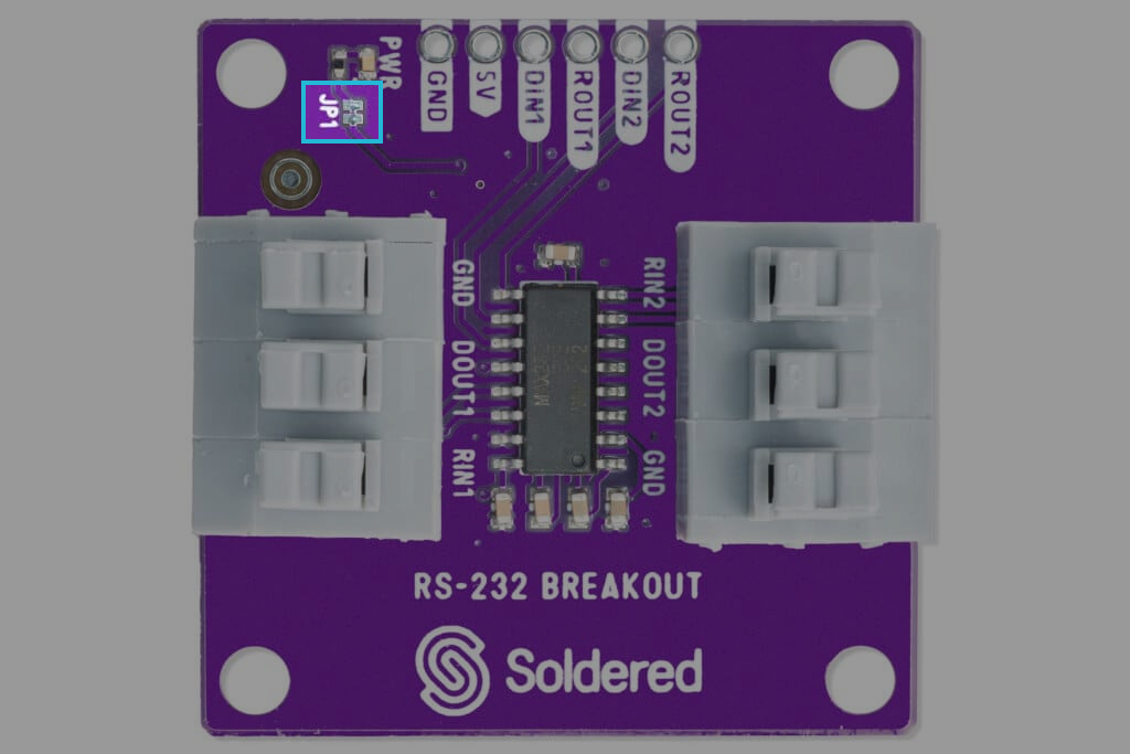

Jumper Details​
This board contains a hardware jumper; see below for its location and function:
RS-232 jumper 1
JP1
JumperDefault StateFunction
JP1NC (Normally closed)Controls the power LED by connecting or disconnecting it from the 5V power supply.
