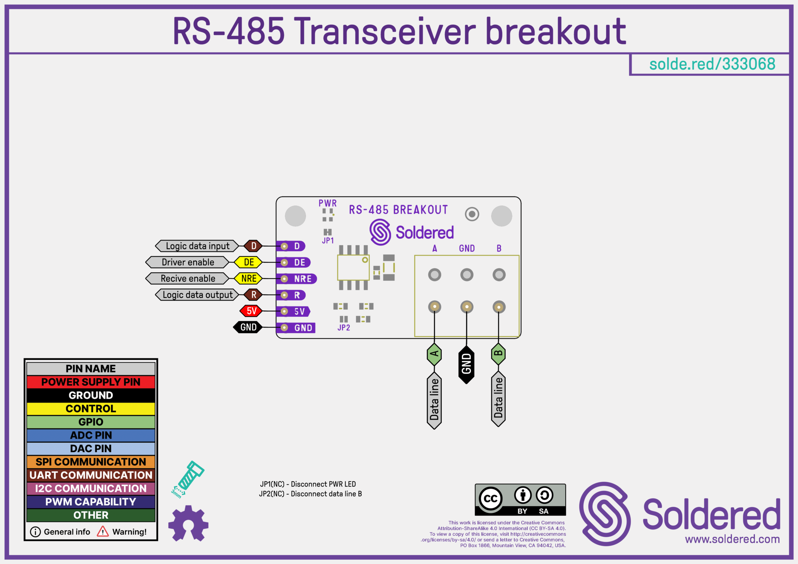

Pinout​
RS-485 transceiver pinout diagram
Pin Details​
DDriver InputAccepts TTL logic data to be transmitted on the RS-485 bus.
DEDriver EnableEnables or disables the driver (active high).
NREReceiver EnableEnables or disables the receiver (active low).
RReceiver OutputOutputs TTL logic data received from the RS-485 bus.
5VSupply VoltagePower input for the board (5V).
GNDGroundCommon ground for both RS-485 and TTL sides.
AData Line ANon-inverting differential data line for RS-485 communication.
BData Line BInverting differential data line for RS-485 communication.
Ensure that GND is connected between all devices on the RS-485 bus to establish a common reference for signals.
Jumper Details​
This board contains a hardware jumper; see below for its location and function:
Loading carousel...
JumperDefault StateFunction
JP1NC (Normally closed)Controls the power LED by connecting or disconnecting it from the 5V power supply.
JP2NC (Normally closed)Enables or disables the 120Ω termination resistor on the RS-485 bus, ensuring proper signal termination at the ends of the communication line.
