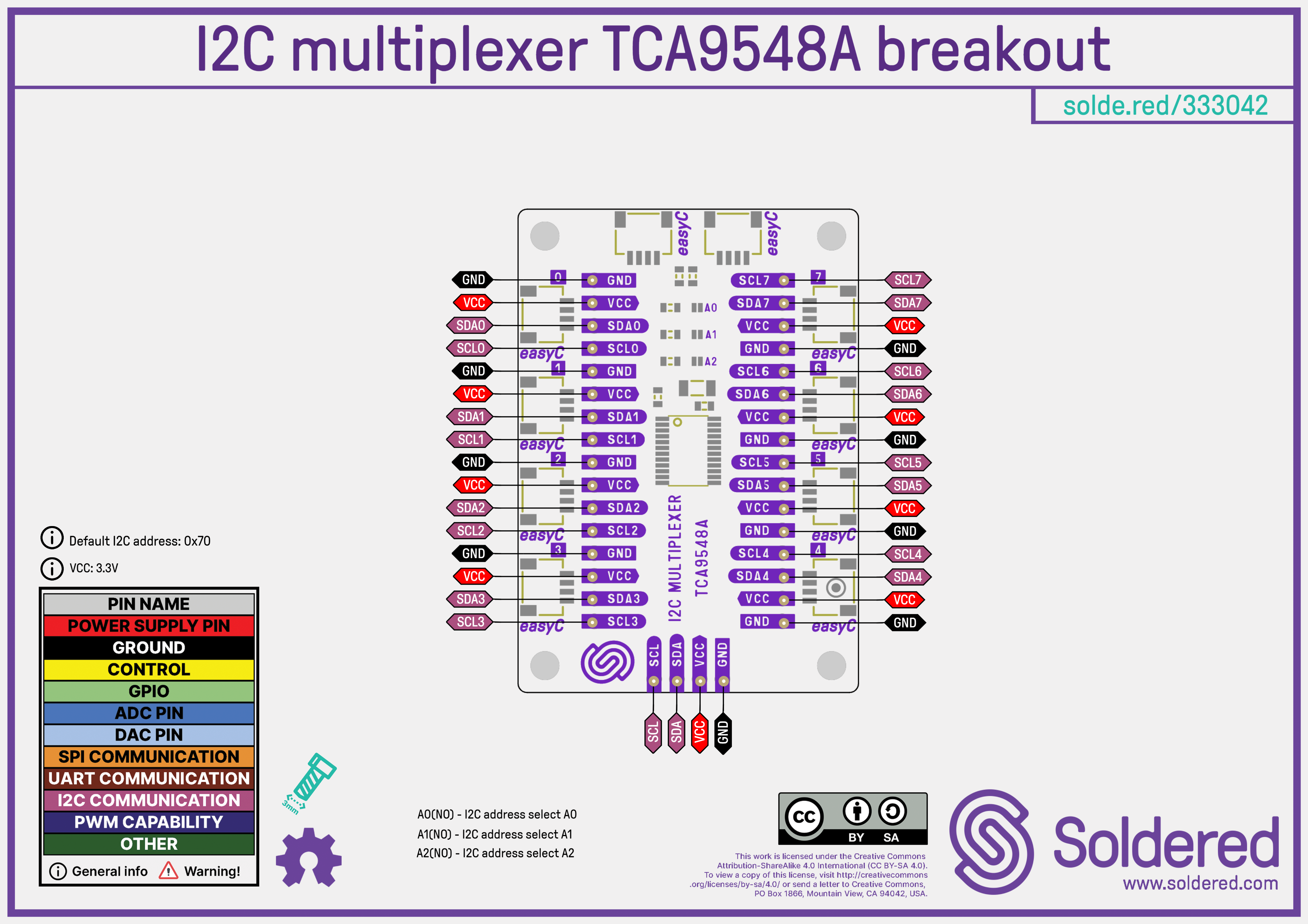

Tca9548A - Hardware details
Pinout
VCCPower SupplySupply voltage (1.65V - 5.5V).
SDA0-SDA7Data LinesIndividual I2C data lines for each channel.
SCL0-SCL7Clock LinesIndividual I2C clock lines for each channel.
SDA/SCLMain BusMain I2C bus data and clock lines.
A0-A2Address SelectAdjustable pins to set the multiplexer address.

Jumper Details​
This board contains hardware jumpers, see below for their locations and functions:
Loading carousel...
JumperDefault StateFunction
A0NO (Normally open)Sets address bit A0 to HIGH when closed.
A1NO (Normally open)Sets address bit A1 to HIGH when closed.
A2NO (Normally open)Sets address bit A2 to HIGH when closed.
Adress selection​
A0A1A2I2C Address
OpenOpenOpen0x70
ClosedOpenOpen0x71
OpenClosedOpen0x72
ClosedClosedOpen0x73
OpenOpenClosed0x74
ClosedOpenClosed0x75
OpenClosedClosed0x76
ClosedClosedClosed0x77
