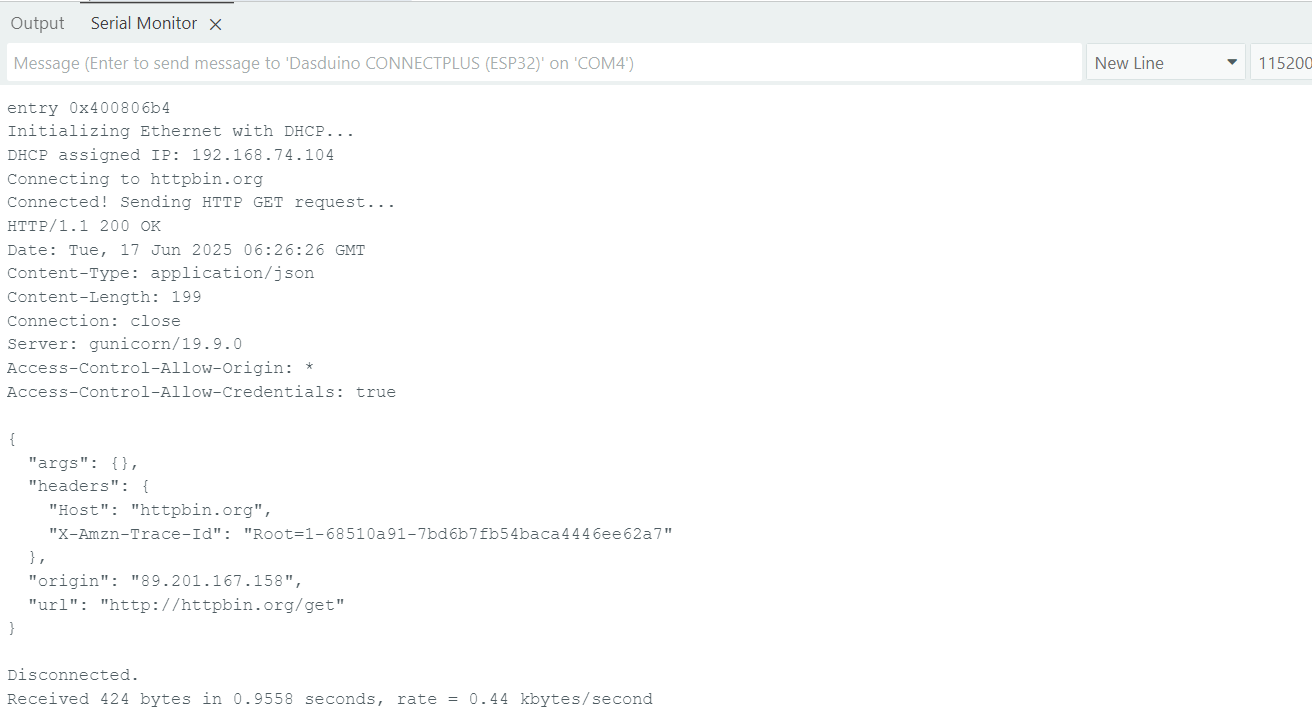

Serial Monitor output​
Output from Serial Monitor
