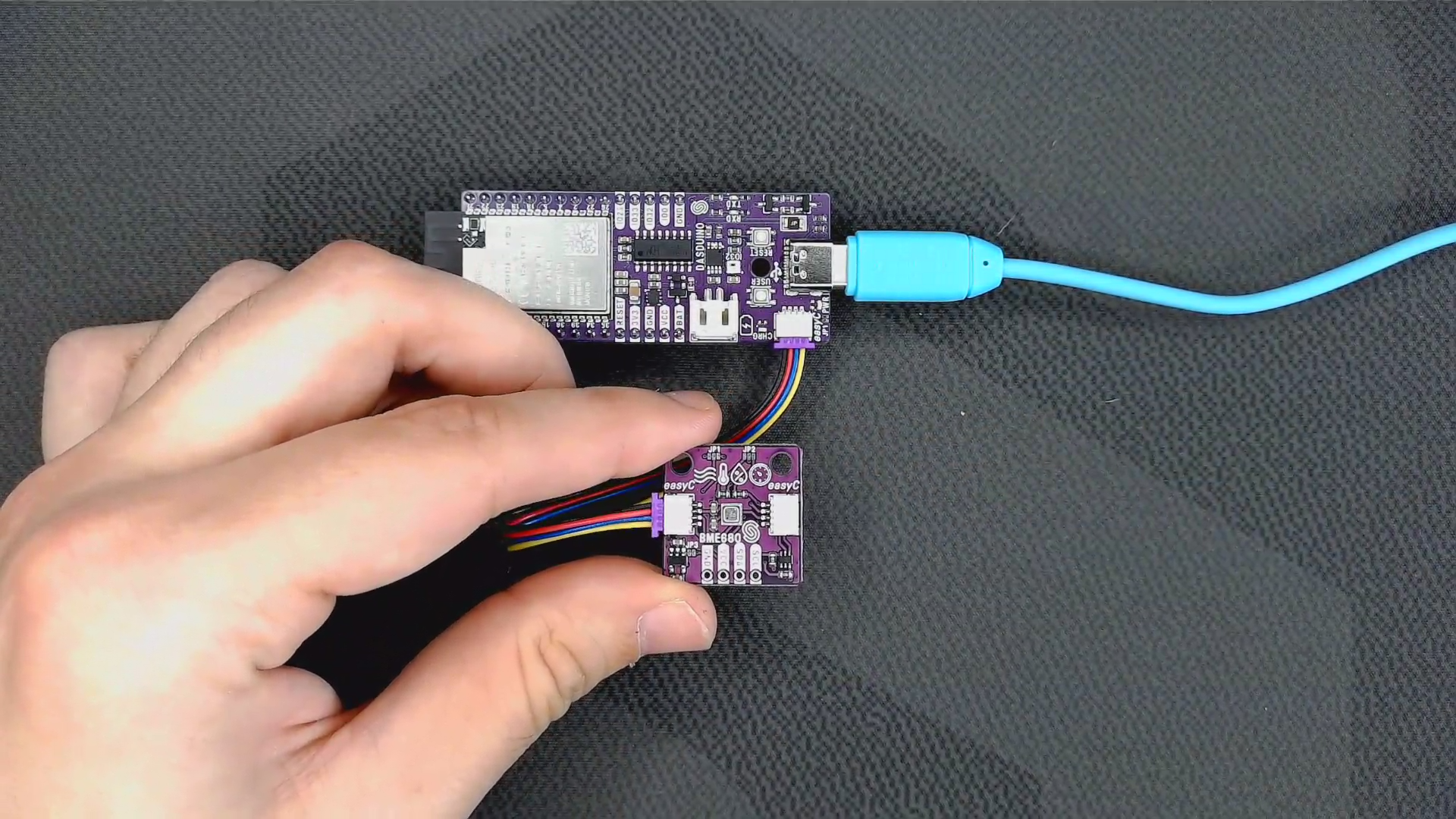

Connections for this example​
Connections
