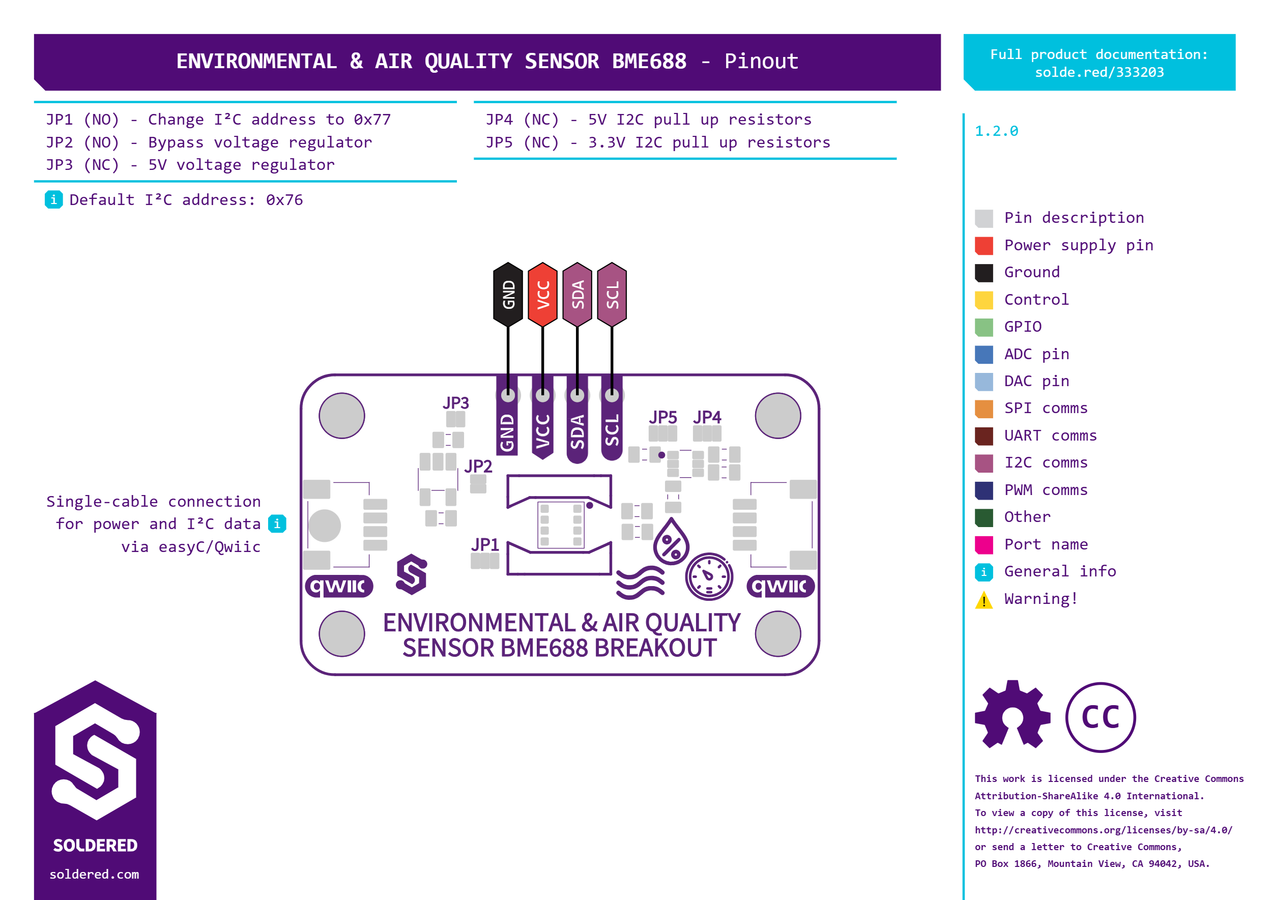

Pinout​
Pin details​
This breakout board operates at 3.3V logic level, but includes an onboard regulator for 5V compatibility so it can be connected to both 3V3 and 5V logic boards!

Jumper Details​
This board contains hardware jumpers. See below for their locations and functions:
Loading carousel...
JumperDefault StateFunction
JP1Normally openUsed to change the device address. When shorted to GND, the address is 0x76, 0x77 when connected to VCC.
JP2Normally openWhen connected, the voltage regulator is powered by 5V
JP3Normally closedEnables the Voltage regulator
JP4Normally closedConnects SDA/SCL pull-up resistors to 5V for I2C communication.
JP5Normally closedConnects SDA/SCL pull-up ressitors to 3.3V for I2C communication.
