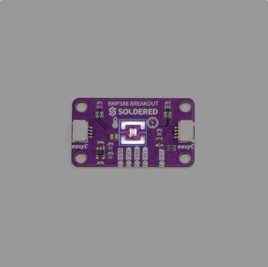

The BMP388 is an integrated circuit by Bosch. When using our board, you are essentially communicating directly with the onboard BME280 via I2C communication.
BMP388 sensor on board
Onboard BMP388 sensor

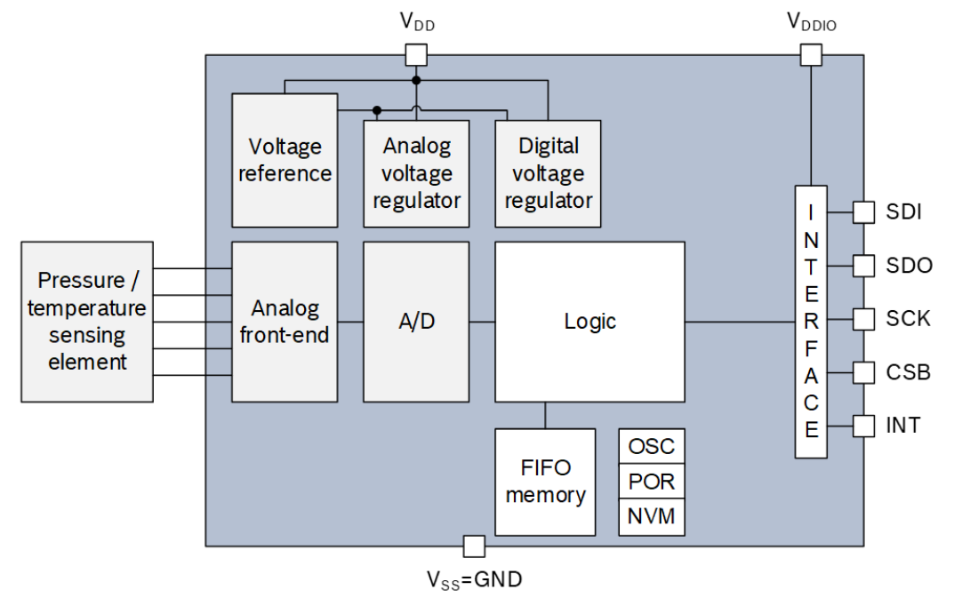

BMP388 simplified block diagram
Temperature sensors work by measuring the capacitance or resistance of air samples.
A barometric pressure sensor works by using a flexible diaphragm that deforms under atmospheric pressure, converting this physical change into a measurable electrical signal.

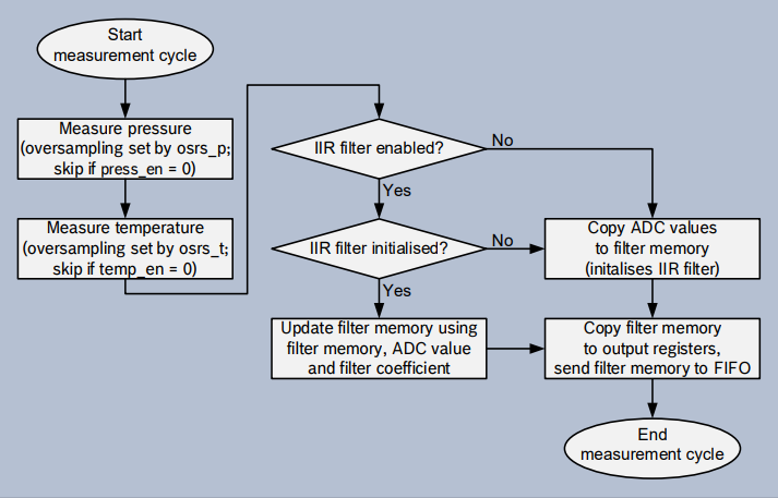

BMP388 measurement flow chart
It has three operating modes:
  • Sleep: Lowest power consumption mode; no measurements are performed, and all registers are accessible.
  • Forced: Suitable for situations that do not require frequent measurements, such as when reading weather conditions. One measurement is performed, the data is saved to registers, and the sensor returns to sleep mode. This method reduces power consumption.
  • Normal: Constantly performs measurements with an adjustable delay (i.e., inactive time).
