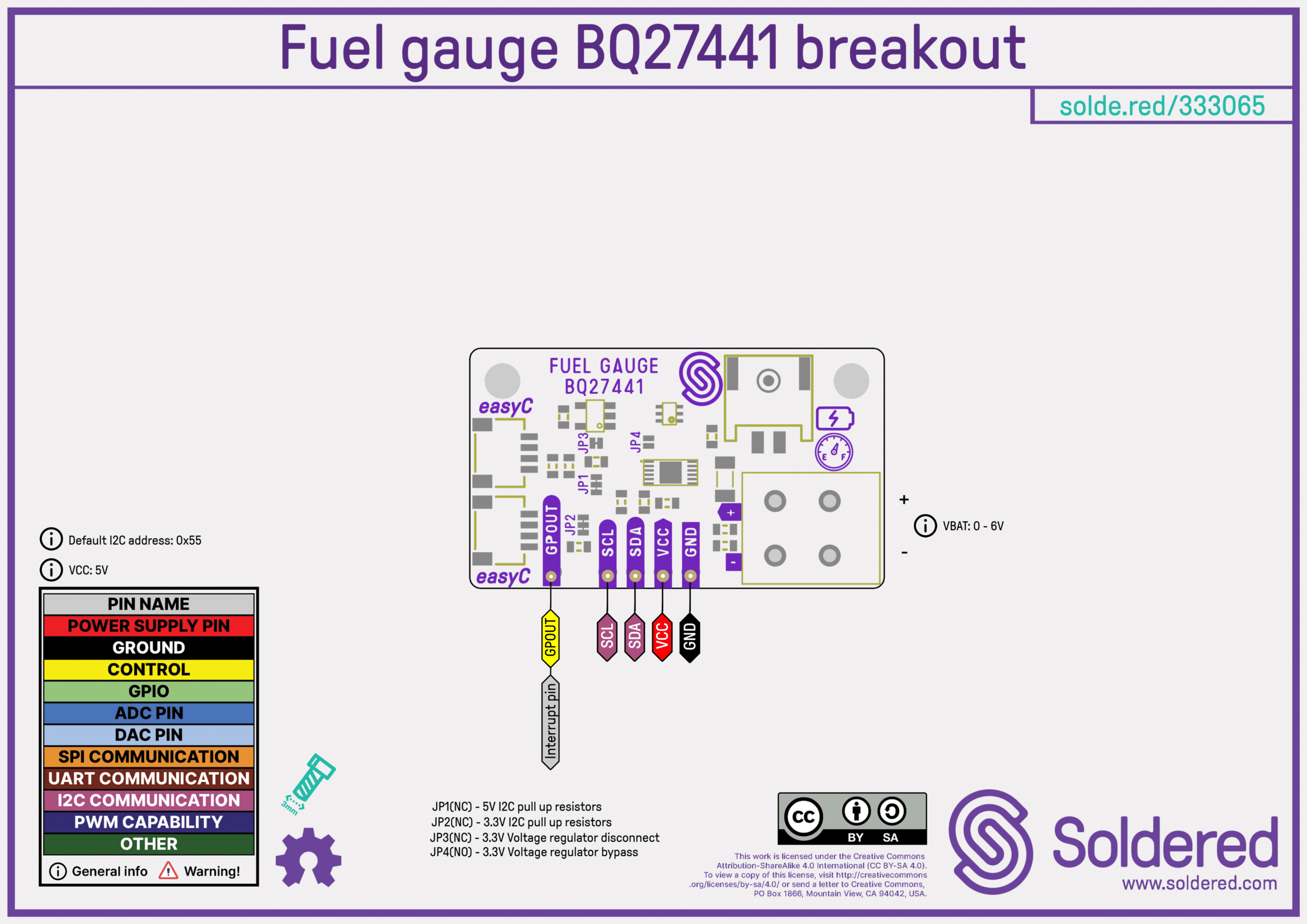

Pinout​
BQ27441 Fuel gauge pinout diagram
Pin MarkingPin Name¸Description
GNDGroundCommon ground for power and signals
VCCPower5V Supply voltage
SDADataI2C data line for communication
SCLClockI2C clock line for communication
GPOUTInterruptControl pin

Jumper Details​
Loading carousel...
JumperDefault StateFunction
JP1NC (Normally closed)Connects SDA/SCL pull up ressitors to 5V for I2C communication.
JP2NC (Normally closed)Connects SDA/SCL pull-up ressistors to 3.3V for I2C communication.
JP3NC (Normally closed)3.3V Voltage regulator disconnect
JP4NO (Normally open)3.3 V Voltage regulator bypass
