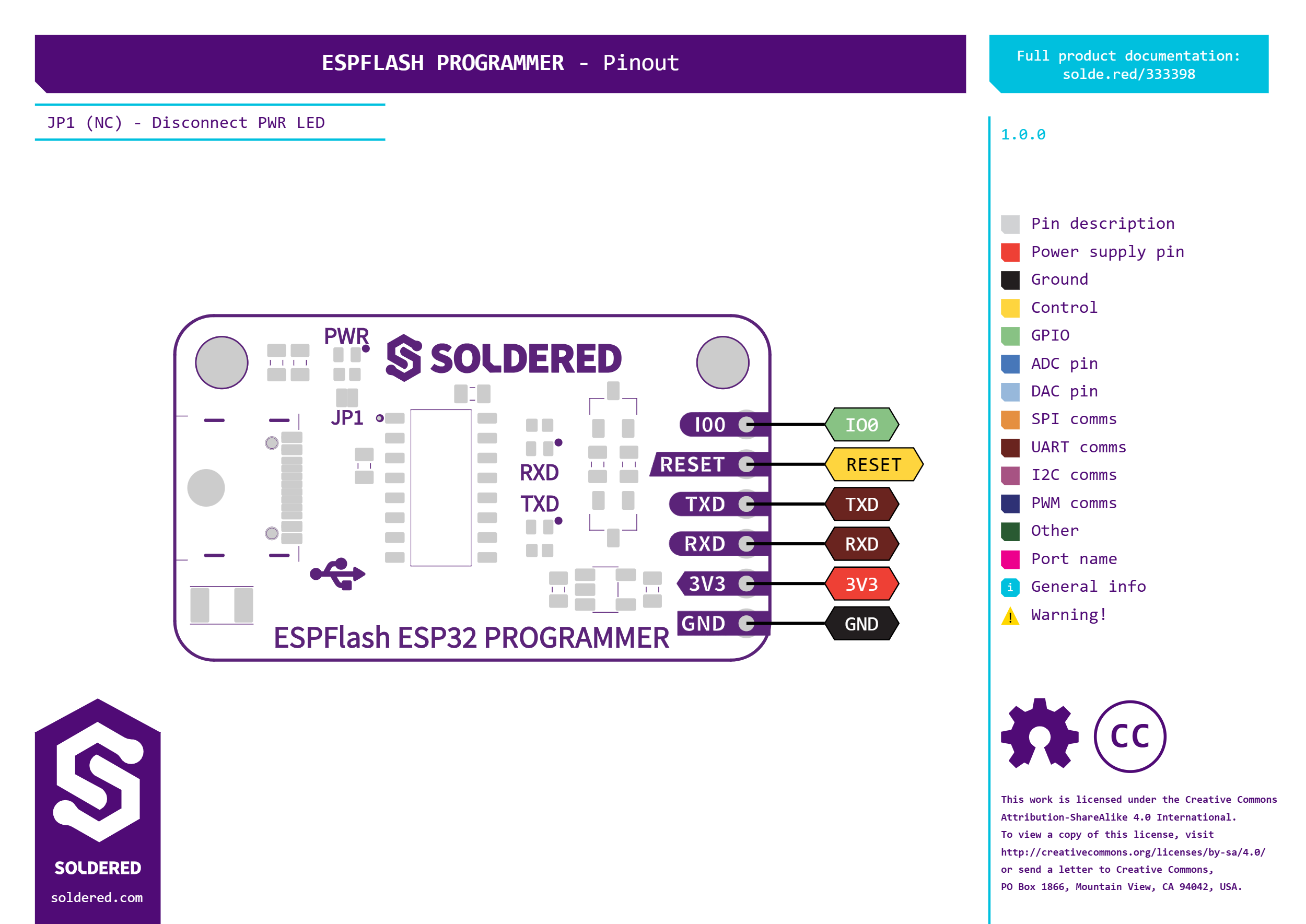

Pinout​
ESPFlash Programmer pinout
Pin details​
IO0OutputPin used to set the ESP into bootloader mode. Held low during reset to enter it
RESETOutputResets the ESP when pulled low
TXDTransceiverTransceiver pin for UART communication
RXDReceiverReceiver pin for UART communication
3V3PowerProvides 3V3 to the ESP
GNDGroundConnects to the GND pin of the ESP

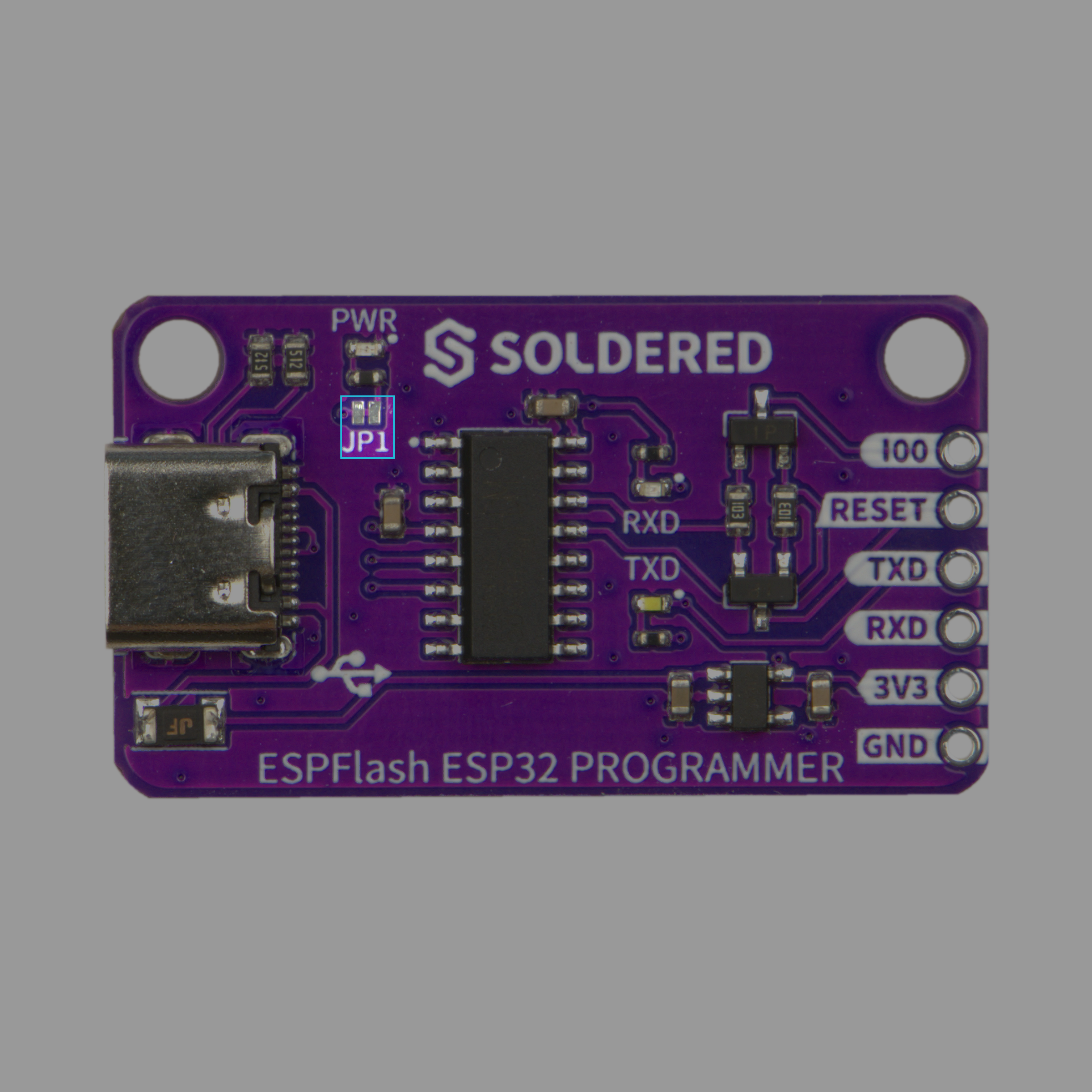

Jumper Details​
JP1 jumper highlighted
JP1 jumper location
JumperDefault StateFunction
JP1NC (Normally closed)Connects the onboard Power LED to 3V3
