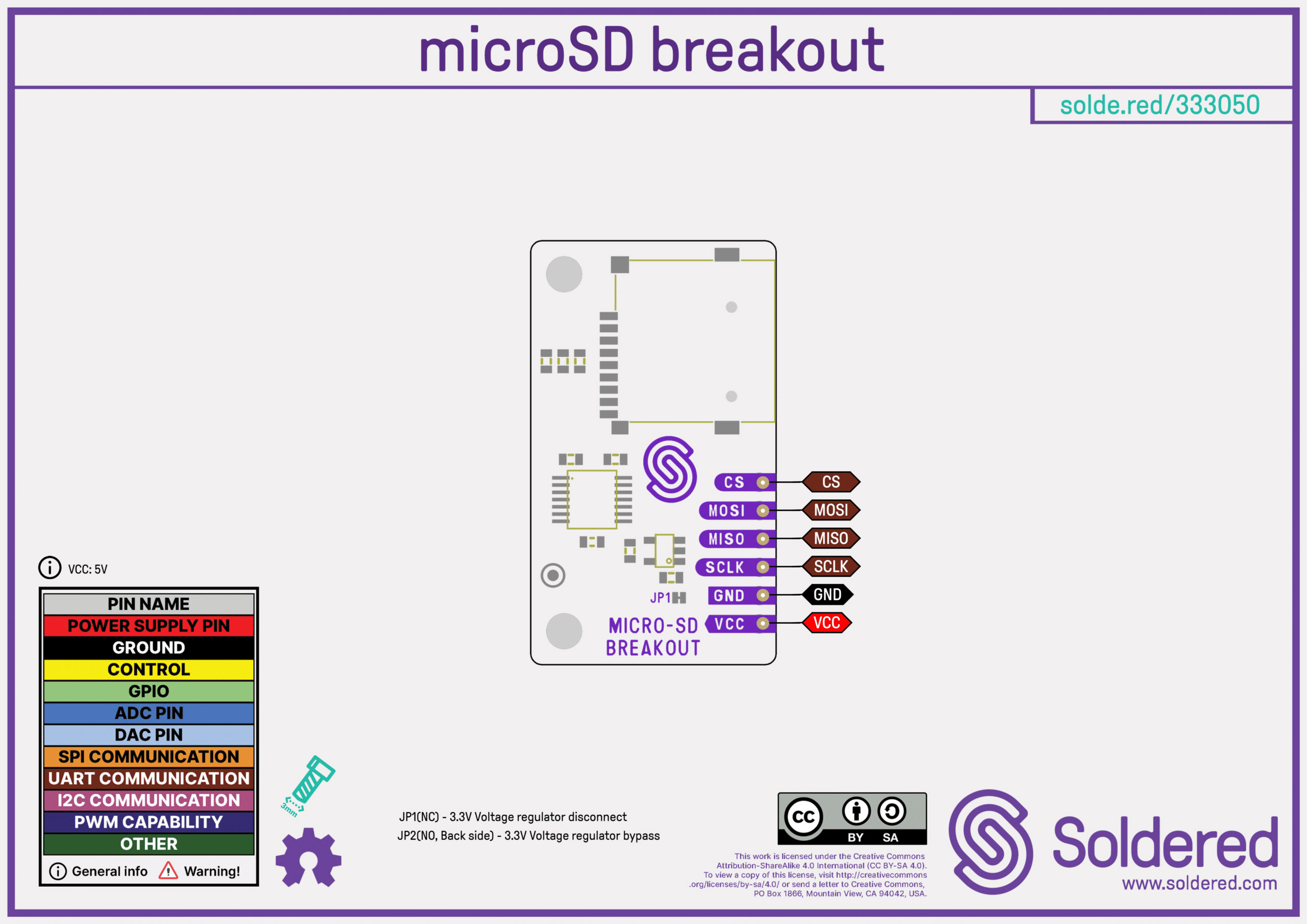

Pinout​
Pinout
Pin details​
VCCPowerSupply voltage (5V)
CSChip selectIndicates whether the chip is selected for SPI communication by the leader
MOSILeader out follower inSerial data output from the leader
MISOLeader in follower outSerial data output from the follower
Jumper Details​
Loading carousel...
JumperDefault StateFunction
JP1NC (Normally closed)Disconnects the 3.3V voltage regulator
JP2NO (Normally open)When shorted, bypasses the 3.3V voltage regulator
Dimensions​
  • Board Dimensions: 38 x 22 mm (1.5 x 0.9 inch)
  • Header Pin Holes: 1.5 mm
