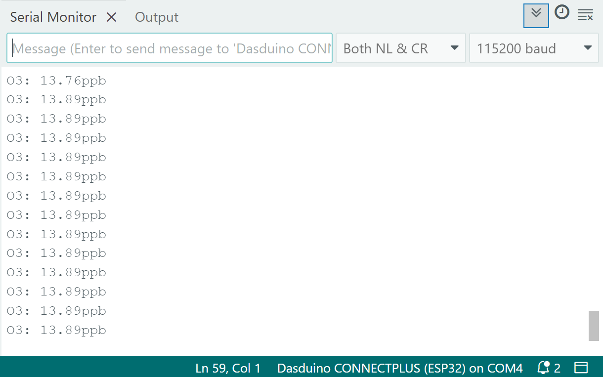

When you have initialized the sensor (either Qwiic or Native), we can read the sensor measurements in the loop() function:
void loop()
mq131.update(); // Update data, read voltage level from sensor
Serial.println("O3: " + String(mq131.readSensor())+"ppb"); // Print the readings to the serial monitor
delay(500); // Sampling frequency
Sensor reading on serial monitor
