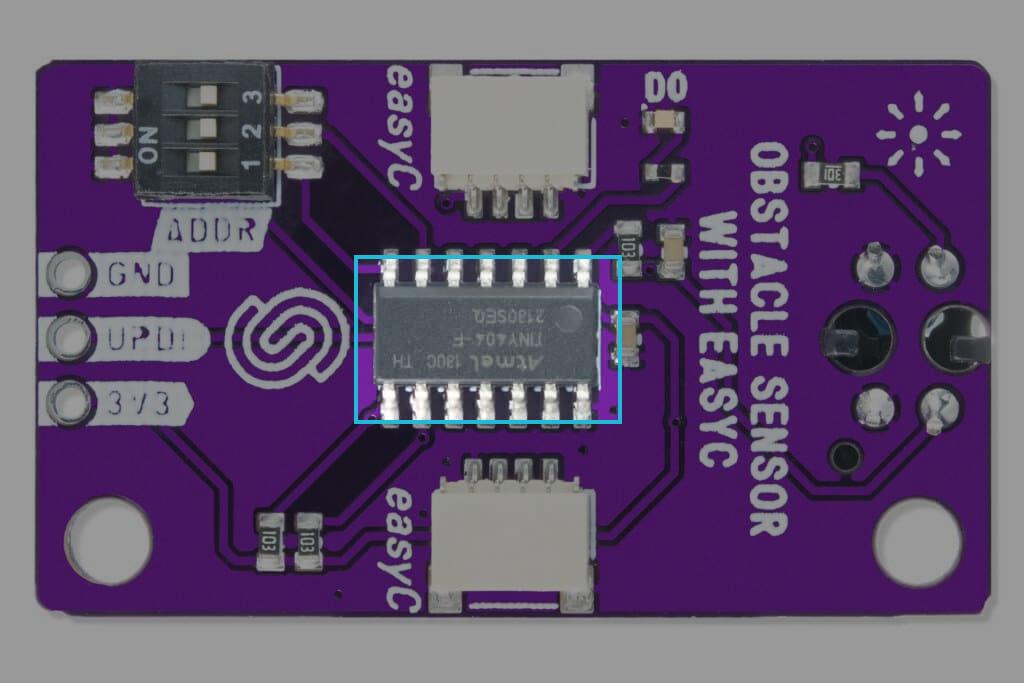

This board utilizes TCRT5000 infrared reflective sensor by Vishay to detect the presence of objects or colors. To make it easier to use, this board employs a preprogrammed ATTiny404 IC for binary output and I2C communication.
TCRT5000 IR sensor on board
ATTiny404 IC on board

This board uses an onboard ATTiny404 MCU to implement I2C communication. The board operates on a default I2C address of 0x30, but it can be changed using onboard switches. To change the board's address, check the Address selection. When detected, ATTiny404 receives data from the sensor and passes it to the main MCU using the I2C data line. To check in detail how the ATTiny404 is preprogrammed, check the firmware GitHub page.
