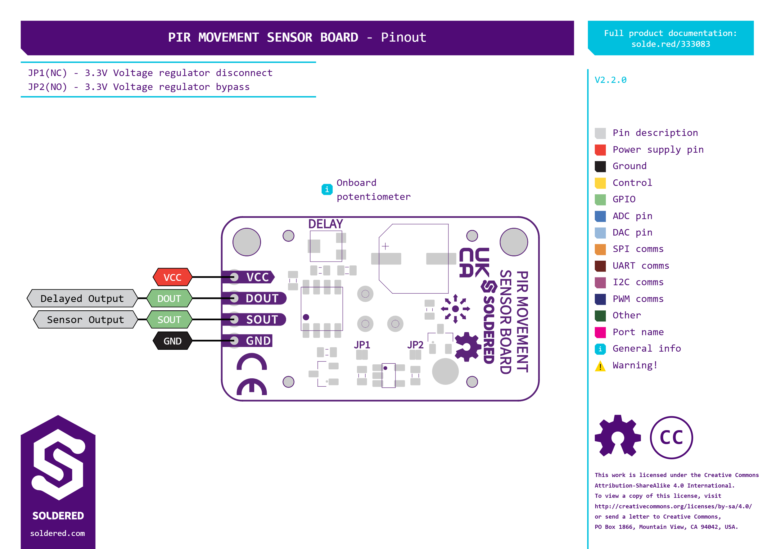

Pinout​
Standard version​
The pinout image for this board hasn't been generated yet! We're working on it!
VCCPowerSupply voltage
DOUTDelayed outputGets delayed output depending on MCU
SOUTSensor outputGets instant sensor output

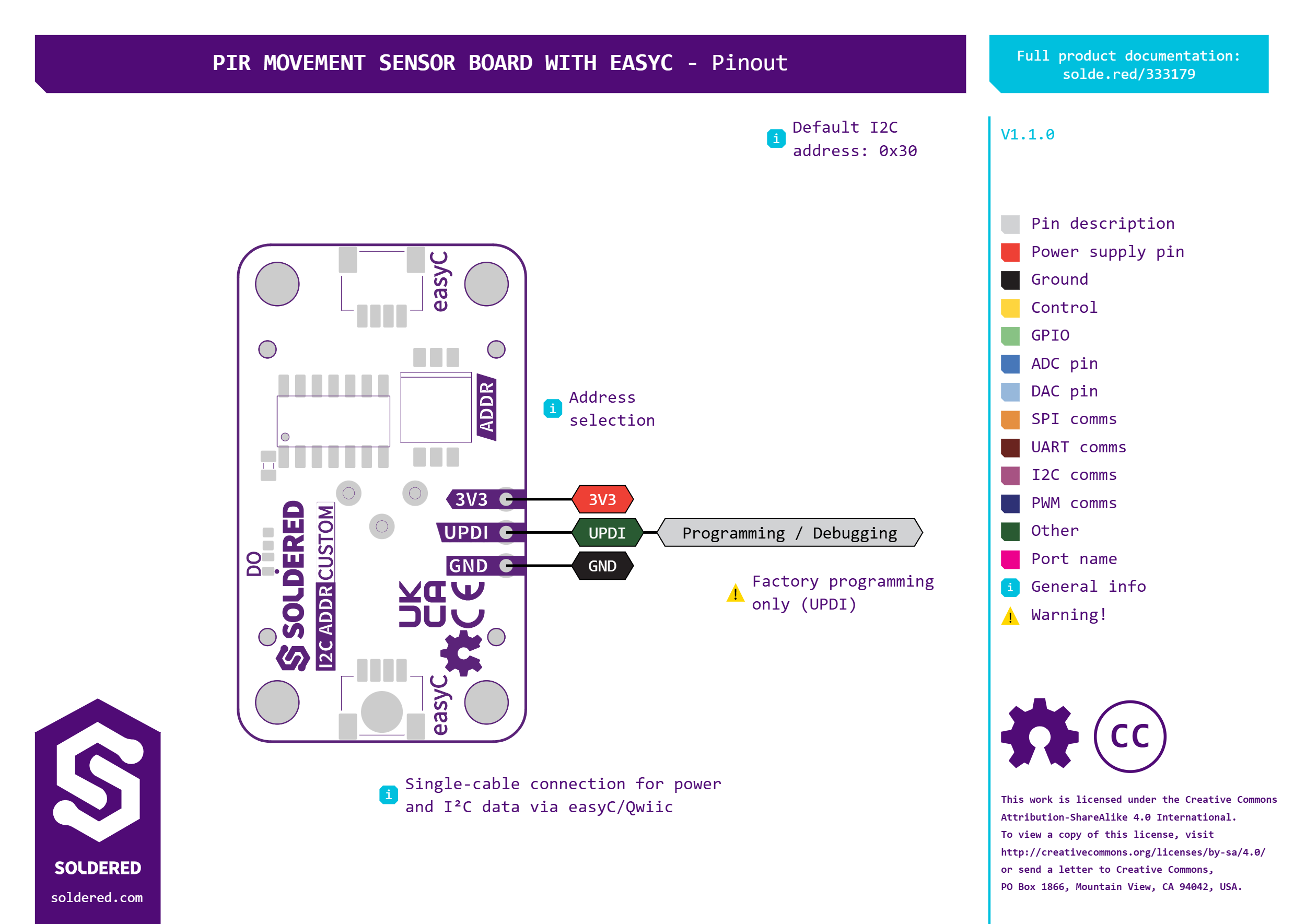

Qwiic version​
3V3PowerSupply voltage for the UPDI
UPDIUPDICommunication pin for UPDI
UPDI stands for Unified Program and Debug Interface. It is used to program and debug Atmel devices. The atmel chip on this board is used for the easyC I2C communication only. DO NOT try to use this for sensor communication!
EasyC/qwiic cable

Jumper Details (Standard version)​
This board contains hardware jumpers, see below for their locations and functions:
Loading carousel...
JumperDefault StateFunction
JP1NC (Normally closed)When shorted, Connects the voltage regulator to 5V
JP2NO (Normally closed)When shorted, bypasses the voltage regulator

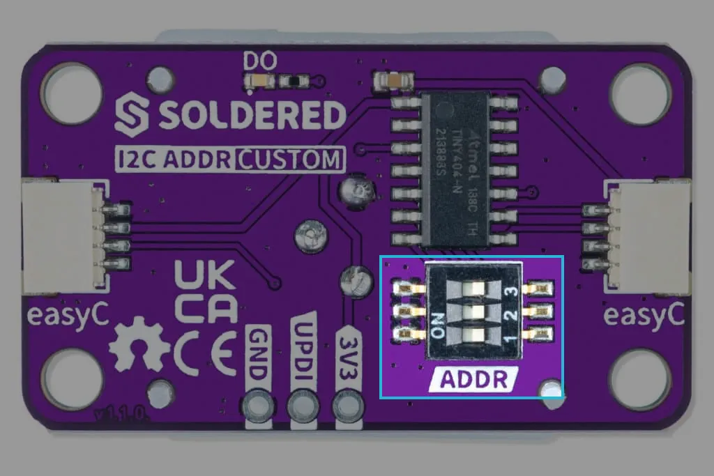

Address selection (Qwiic version)​
This board contains hardware address switches, see below how to change breakout board's address:
Pinout
AddressSW3SW2SW1
0x30000
0x31001
0x32010
0x33011
0x34100
0x35101
0x36110
0x37111
