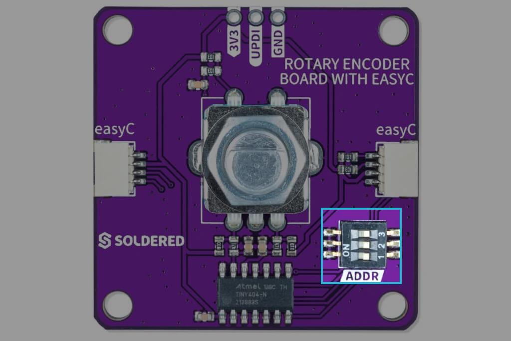

Address selection​
This board contains hardware address switches, see below how to change breakout board's address
Address selection
AddressSW3SW2SW1
0x30000
0x31001
0x32010
0x33011
0x34100
0x35101
0x36110
0x37111
