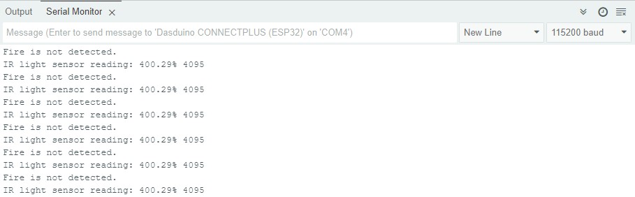

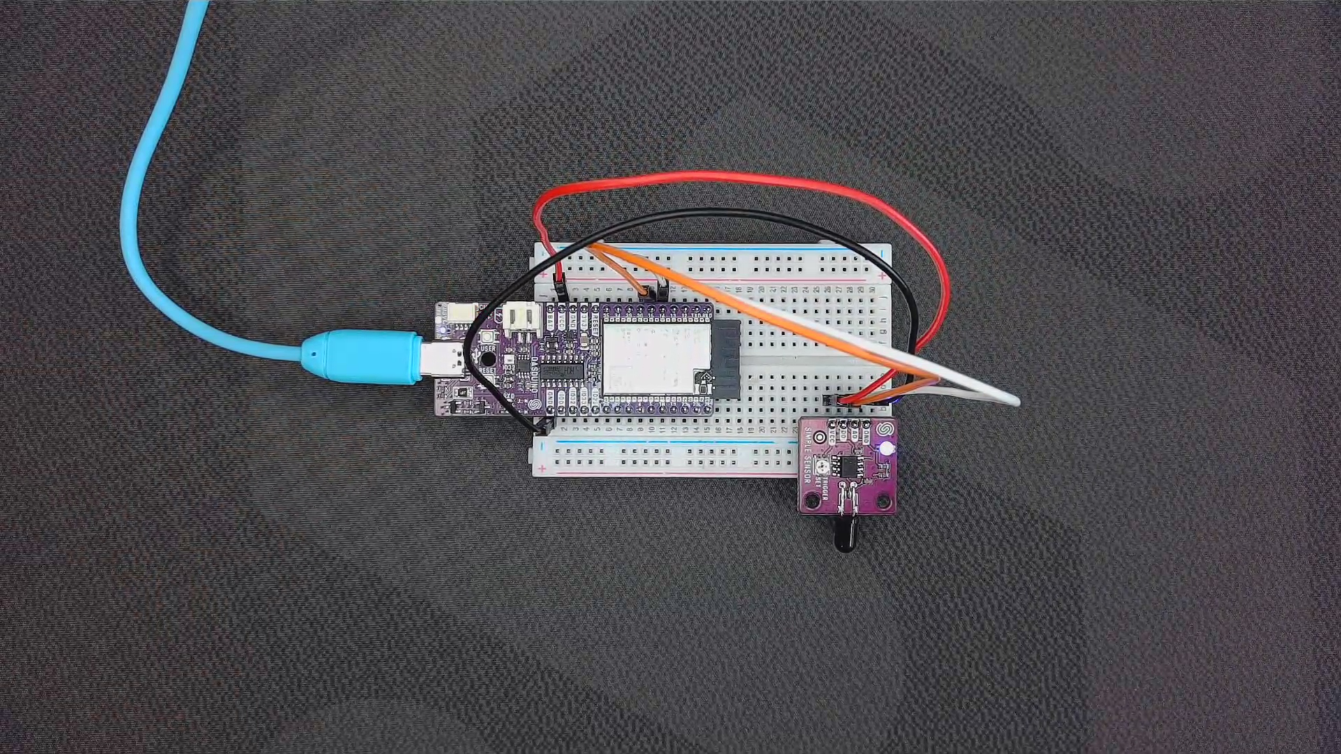

Sensor when fire is not present
Serial Monitor output

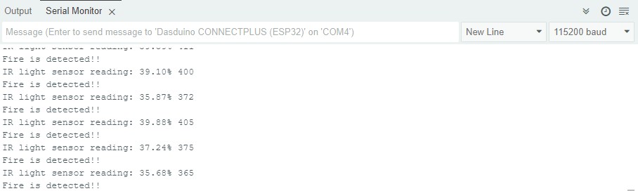

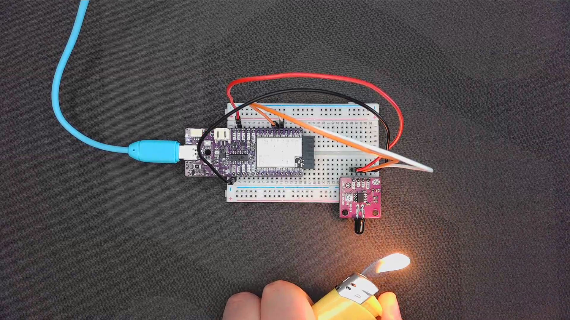

Sensor when fire is present
