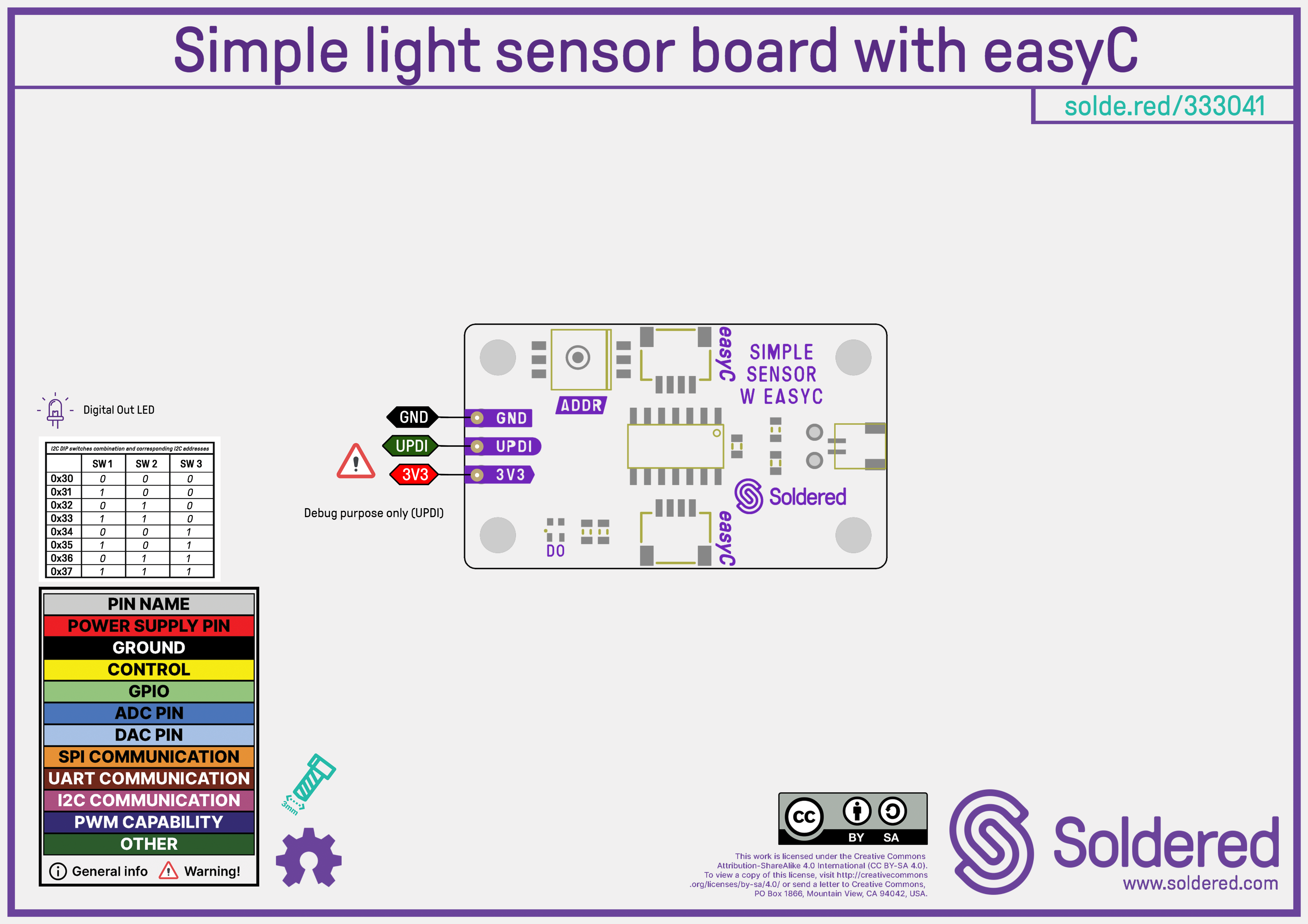

Pinout​
Pinout
Pinout

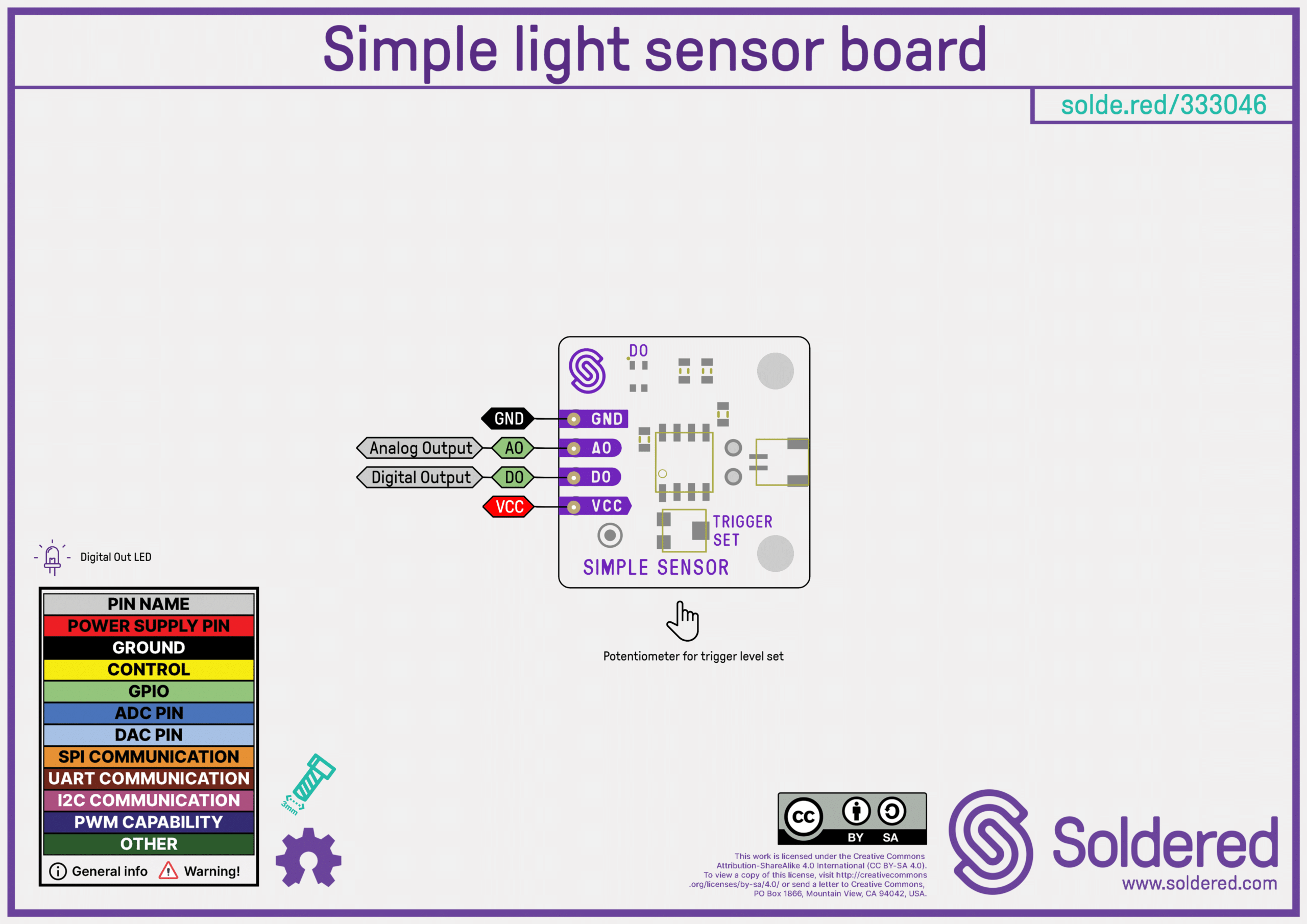

Pin details for regular version​
A0DataAnalog output pin.
D0DataDigital output pin.
VCCPowerSupply voltage
Dimensions for regular version​
  • Header Pin Holes: 1.5 mm
Pin details for Qwiic version​
For Qwiic version, connection is achieved with Qwiic connector.
Qwiic versions also contain UPDI headers for preprogramming the onboard ATTINY404 MCU, they are used only for debugging purposes.
Dimensions for Qwiic version​
  • Board Dimensions: 38 × 22 mm (1.5 × 0.9 inch)

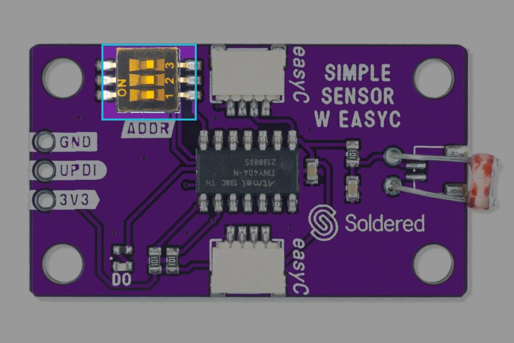

Address selection for Qwiic version​
This board contains hardware address switches. See below for instructions on how to change the breakout board's address.
Address Switches
AddressSW3SW2SW1
0x30000
0x31001
0x32010
0x33011
0x34100
0x35101
0x36110
0x37111
