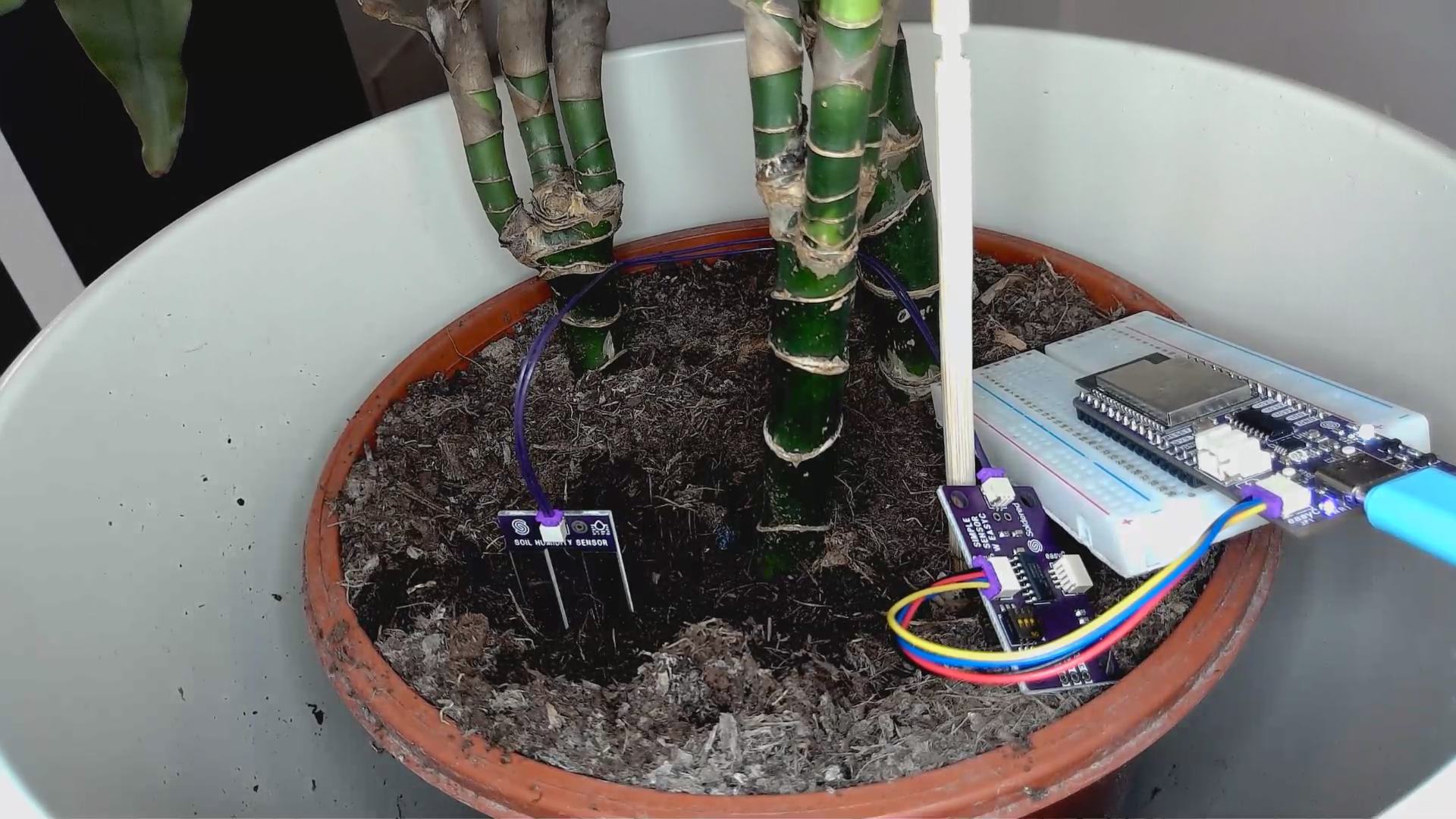

Sensor when water is not present

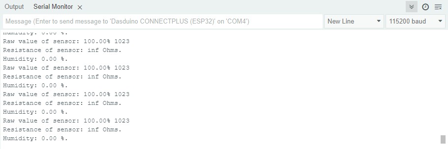

Serial Monitor output
