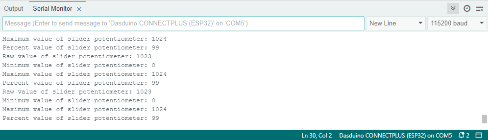

Slider potentiometer(Qwiic) readings 1
Serial Monitor output for position 1

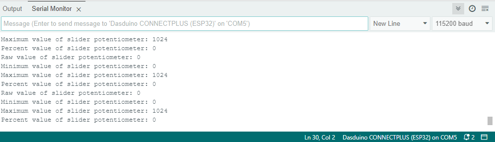

Slider potentiometer(Qwiic) readings 2
Serial Monitor output for position 2
