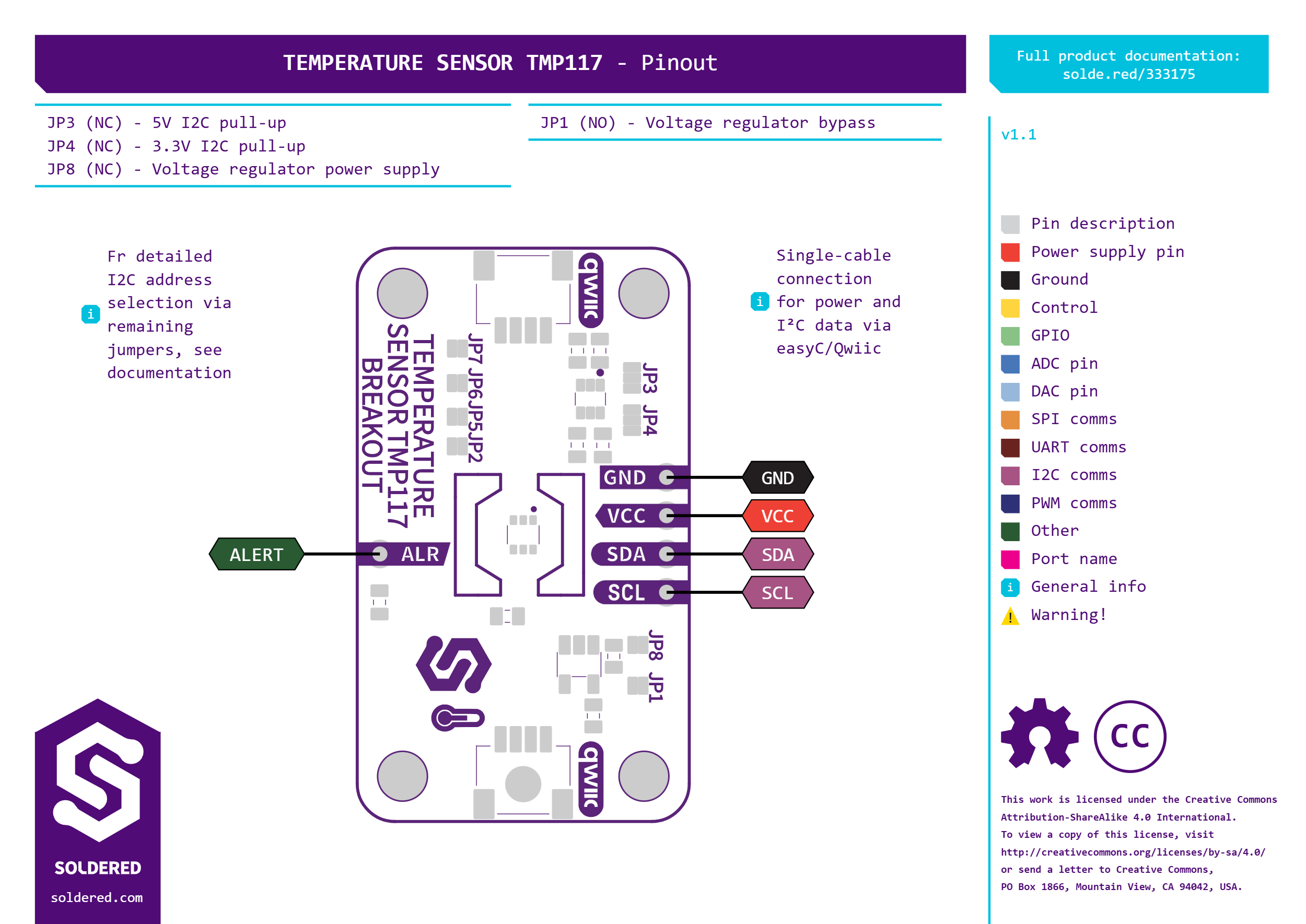

Pinout​
TMP117 Pinout
Pin details​
VCCPowerPower supply input (1.7 V – 5.5 V).
GNDGNDGround reference for power and signals.
SCLClockSerial clock input for I²C/SMBus communication.
SDADataSerial data line (open-drain, requires pull-up resistor).
ALERTALERTConfigurable pin: over-temperature alert or data-ready signal (open-drain).

Jumpers​
JumperDefault StateFunction
JP1NO (Normally open)When shorted, bypasses the voltage regulator, allowing direct 3.3V supply via headers.
JP2NC (Normally closed)Connects ADD0 pin to 3.3V, setting I²C address accordingly.
JP3NC (Normally closed)Connects I²C pull-up resistors to 5V for SDA/SCL lines.
JP4NC (Normally closed)Connects I²C pull-up resistors to 3.3V for SDA/SCL lines.
JP5NO (Normally open)Connects ADD0 pin to SCL (3.3V) for I²C address selection.
JP6NO (Normally open)Connects ADD0 pin to SDA (3.3V) for I²C address selection.
JP7NO (Normally open)Connects ADD0 pin to GND for I²C address selection.
JP8NC (Normally closed)Enables voltage regulator to power the board from 5V input (steps down to 3.3V for the TMP117).
