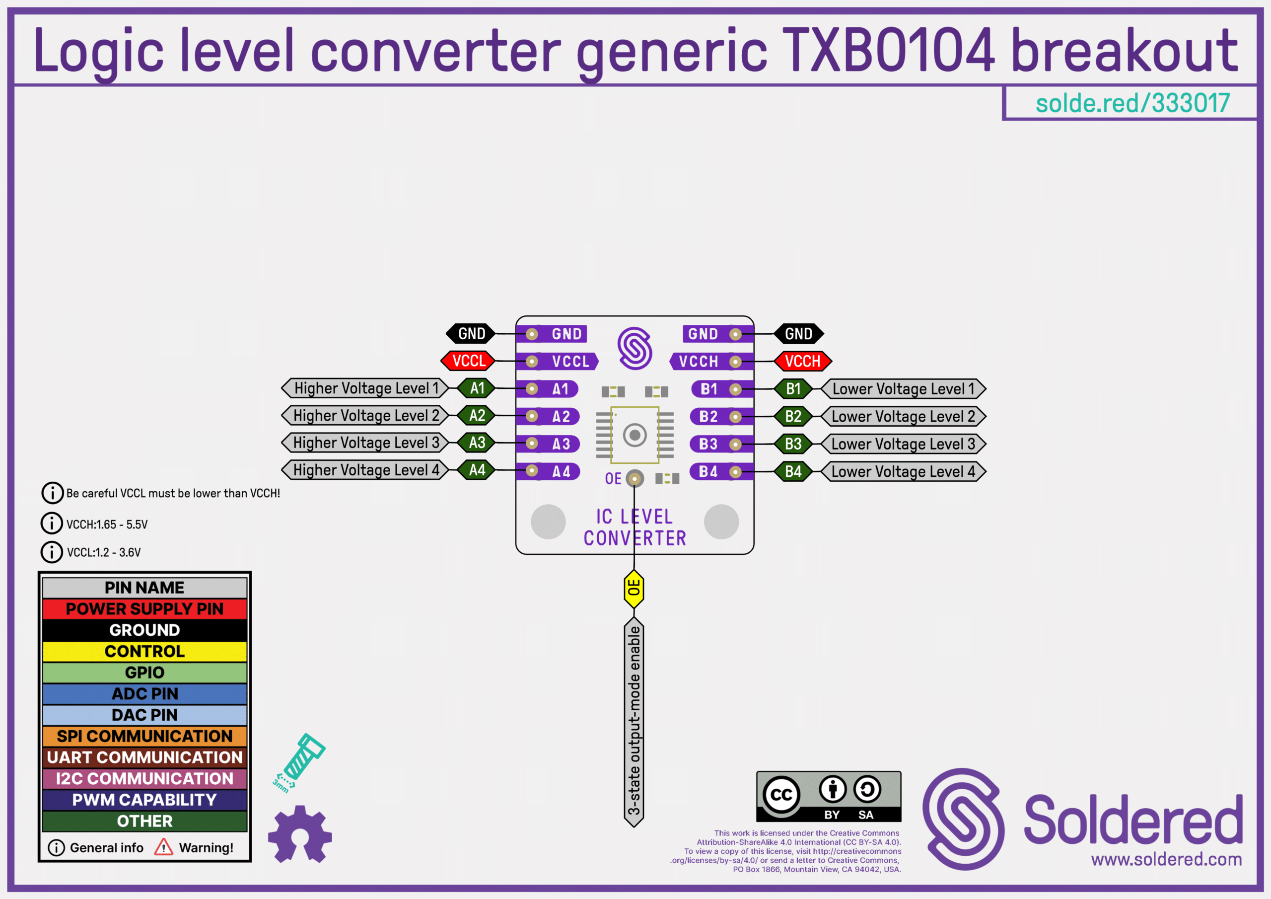

Pinout​
Logic Level Converter pinout diagram
Logic Level Converter TXB0104 pinout diagram
Pin Details​
GNDGroundCommon ground for both high and low voltage sides.
VCCHHigh Voltage PowerSupply voltage for the high-voltage side (typically 5V).
VCCLLow Voltage PowerSupply voltage for the low-voltage side (typically 3.3V).
B1 - B4High Voltage PinsHigh-voltage side signal pins (typically 5V logic).
A1 - A4Low Voltage PinsLow-voltage side signal pins (typically 3.3V logic).
OEOutput Enable PinEnables or disables output, switching between active (HIGH/LOW) and high-impedance (Hi-Z) states.
  • VCCH: 2.3V - 5V
  • VCCL: 1.65V - 3.6V
VCCL must be lower than VCCH!
Ensure that GND is connected to both the high and low voltage grounds to establish a common reference for signals.
