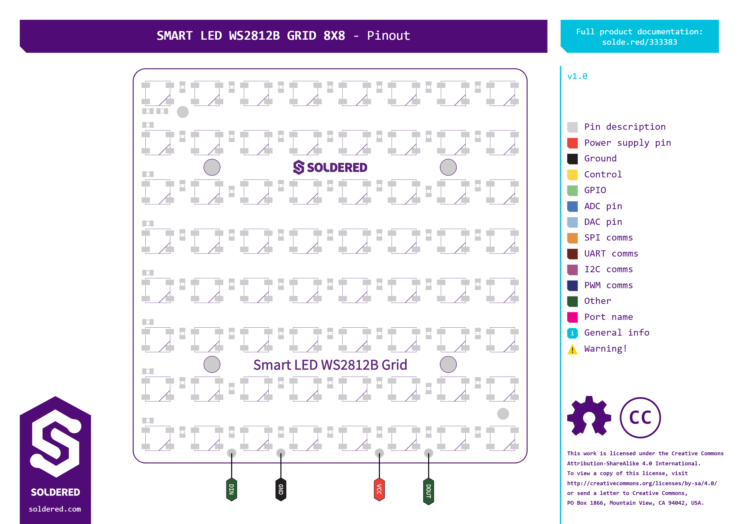

Hardware details
Pinout​
Pinout
Pin Details​
DINData InputSerial-Data input.
VCCPower5V Supply voltage.
DOUTData OutputSerial-Data output.
Dimensions​
  • Board Dimensions: 80 x 80 mm (3.15 x 3.15 inch)
  • Header Pin Holes: 1.5 mm
